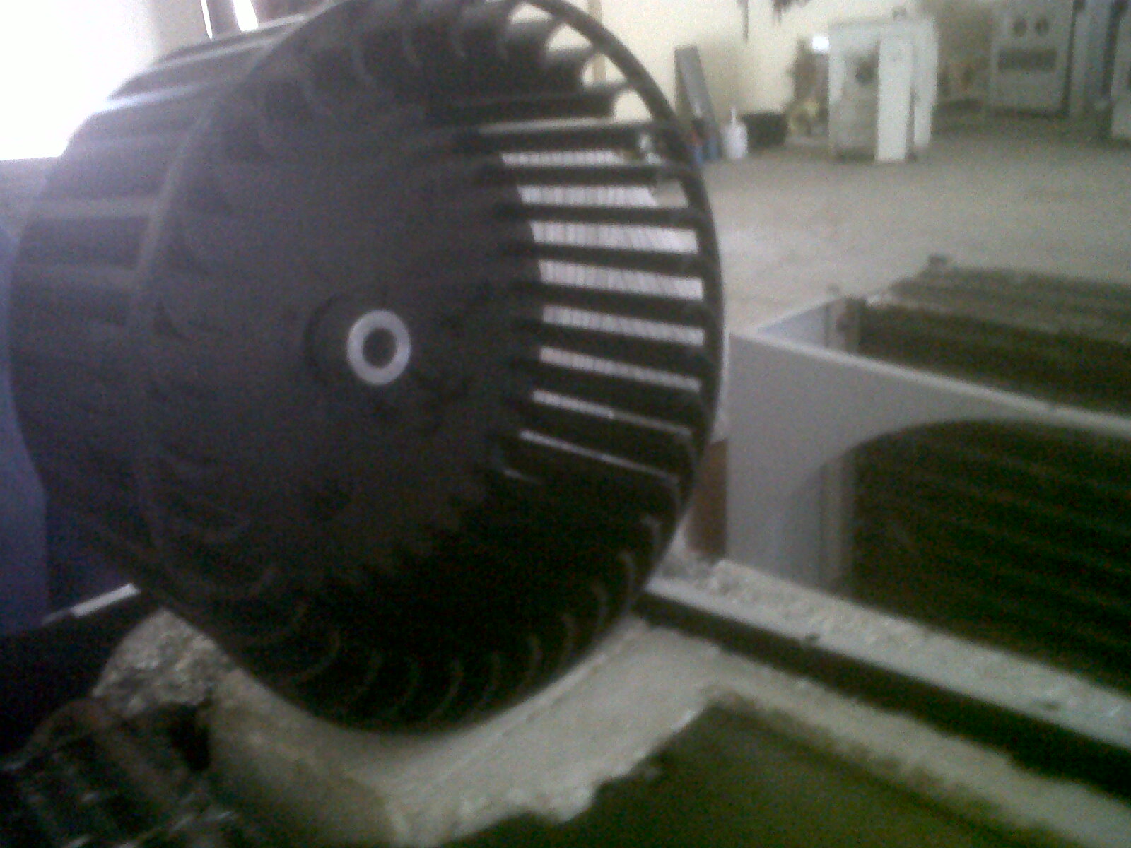

here i am attaching fan image. this wieghs 450gms. These are rested on either side of shaft.
radius of fan is 20cm
shaft dia is 0.5 inch.
1)How can i balance load here??
2) motor should run 48v,5A,2500rpm, application air condition blowers
mysetup is like this. I am using fan
http://www.searspartsdirect.com/partsdirect/part-model/whirlpool-parts/air-conditioner-parts/Model-ACM062XH0/1198/0904032/o2028376/00001
Its already been balanced, there's a clip-on weight visible on one of the fan blades.
If its a plastic fan blade then it may change shape with age and become less balanced.
If its designed for 1550rpm then it may not be rated for 2400rpm (forces are 2.4
times as large, both centrifugal and air load forces).
To spin that fan at 2400rpm will take a certain amount of power, and the motor
has to be rated to provide that amount. Finding out what that power is isn't
trivial without a measuring rig. You can't tell what electrical power is needed
without knowing the load power and motor efficiency.
Fan loads depend roughly on the cube of the rotation speed and the reciprocal
of the square of the thermdynamic temperature (because air density changes with
temperature). A datasheet for the fan would provide some answers. The back pressure
of the ducting system its installed in will also affect load. Fans also have a maximum
back-pressure rating, above this the airflow stalls over the blades and they stop
working properly.
