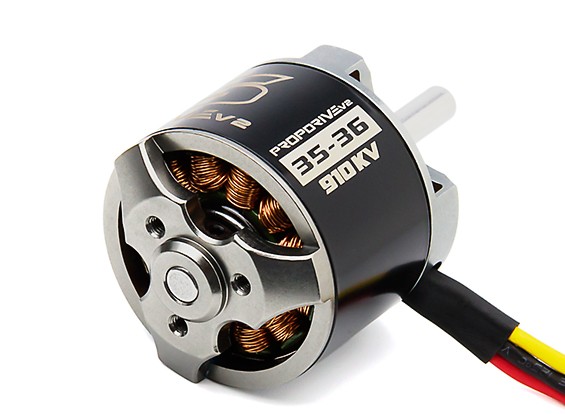

Ah ok. So by light RC motor, do you mean something like a drone brushless outrunner motor?
That one would certainly do it, but you probably don't need a 38A motor, something half the power with Kv of around 1000 should do. Remember these motors are very powerful for their size, and never make the mistake
of trying to handle them when running, can take chunks out of your fingers easily at 12,000 rpm
