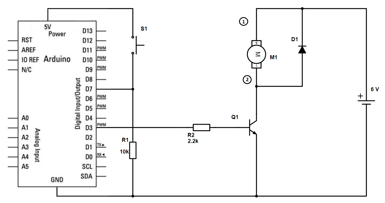

Motor doesn't move in this circuit. Why?
in my attachement, you can find the circuit. It is very simple. All I want to do is to control my motor. Here comes the problem and I really have no clue why this happens.
When I measure the voltage between 1 and 2 and the motor is not in the circuit, i get 6 Volt. Now I put the motor in. Normally it should start to spin. But it doesn't. I measure again between 1 and 2 and I get 0 Volt.
Why? When I put the motor directly on the 6V batterie pack he spins. But when I want to use the motor in the circuit to control it, it doesn't spin, although the circuit works perfect.
You need some code to control the drive to the transistor, which we cannot see.
Try a 220R base resistor.
What transistor are you using?
What is the motor ratings?
The 220 R base resistor changed nothing so far :confused:
The transistor is named as BC 547 B 331
The motor is 6V DC motor with 12500 rpm. I don't know more.
The BC547 will only handle low currents up to 100mA. That is nowhere near enough to run any practical motor I've ever seen. Even tiny pager motors need more than that on startup.
Steve
So I need a different transistor? Can you tell me which one i need? (I just measured the motor current, it is 2.4 A.)

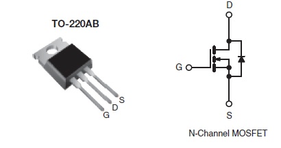

Probably a good option is to use a n-channel mosfet transistor.
The other thing is..... when designing circuits, know as much as you can in advance about what sort of components you need. From what you had been doing, it just appears that you didn't understand what that particular transistor (your bc547 NPN bipolar junction transistor) was capable of..... or not capable of.
Try an IRL540 or FQP30N06

2.4A? No chance whatsoever of driving that from an Arduino with just a BJT, since the Arduino
pins can't output the 0.2A needed for a suitable power device. BJT's as switches need about 5 to 10%
of the load current into the base. The DC current gain isn't relevant for saturated switches.
Your options are darlington (which will definitely need a heatsink at 2.4A), or logic-level MOSFET,
which is much better (can run very cool with the right device - low on resistance).
It must be logic level.

I tried IRL540 and FQP30N06, as well as BUK9535-55. All with a 220R and 470R base resistor and with no resistor. With all comes the same problem:
When i put the pwm level to 100%, then i measure a voltage of 6V at the motor terminal. When i put the pwm level to 1%, i measure 6V, too.

Then something is wrong with the wiring of your circuit. Are the grounds common? Is every connection
sound (ie did you check continuity with a multimeter?). Is the device connected correctly according to
the pin-out? Did you measure the gate voltage with a multimeter to ensure the 5V was getting to the gate?
Have you looked at the data sheet for your IRL540, FQP30N06 and BUK9535-55 and checked the pin allocations.
Can you please post a copy of your circuit, in CAD or a picture of a hand drawn circuit in jpg, png for the MOSFET?
