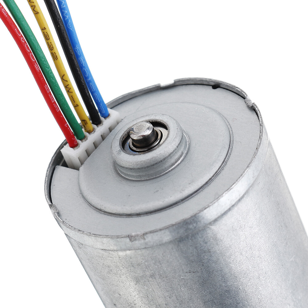

Many motors have already drivers and control wires for speed and direction
the second one two wires for power and 3 for control
