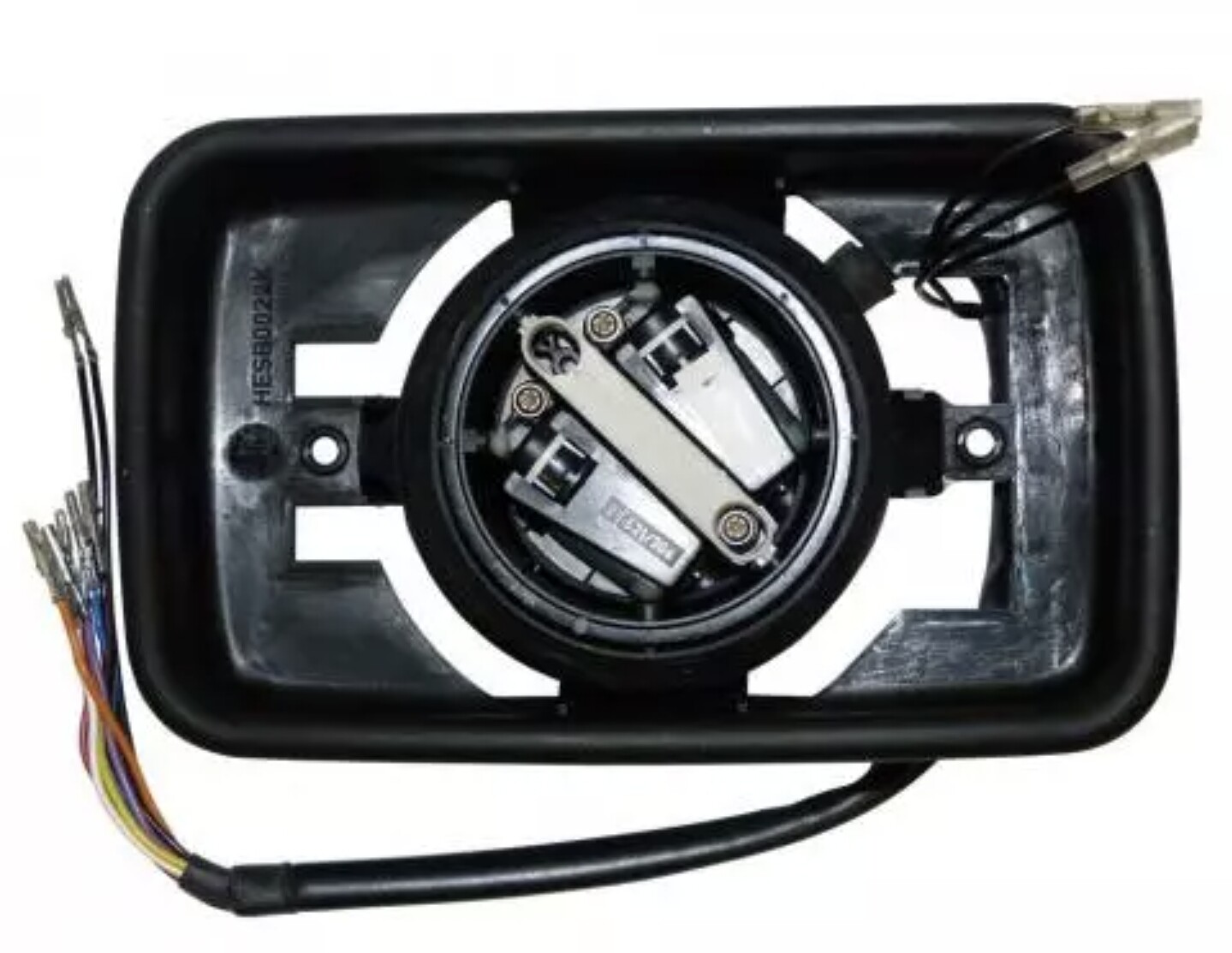

I'm trying to work out how to write the code to stop a motor when it reaches the end of the travel of the attached potentiometer.
I need it to stop when it gets to end of travel cw and end of travel ccw.
I am a bit confussed. I can read A0 and store the value but from there I'm stuck

No. The motor is controlled by 2 relays.
The pot is attached to the output shaft. The motor is geared down

I will need to use the code the control 4 different motors. The motors are wing mirrors of a car. So I need it to be more if its moving cw and the reading on A0 hasn't changed stop the motor or if its moving ccw do the same

They are attached to the motor. They are in a sealed unit
Nice! Do you have access to the three contacts of each potentiometer? And what is the resistance value of the resistors?
The pots share the same 5v supply. The resistance is 3.6k of each pot.
I have access to all the wires
Ok, lets be sure we understand this whole picture. The pots relate to the mirror position and NOT the motor armature position. Correct?
Yes the pot is in relation ro the mirrors position
Ok, back to your first post. With your DVM, measure the voltage on the pot wiper and make a mirror motor go from one limit to the other. Record the voltages you see on the DVM. Those voltages will be your limits. Any voltage in between will relate to the mirror position, as you know.
Then connected to A0 of your Arduino, display the raw values on the serial monitor as you make the same motor movements as your did for the DVM. Record these values as they will be the limits your code will be looking for to stop the motor movement.
