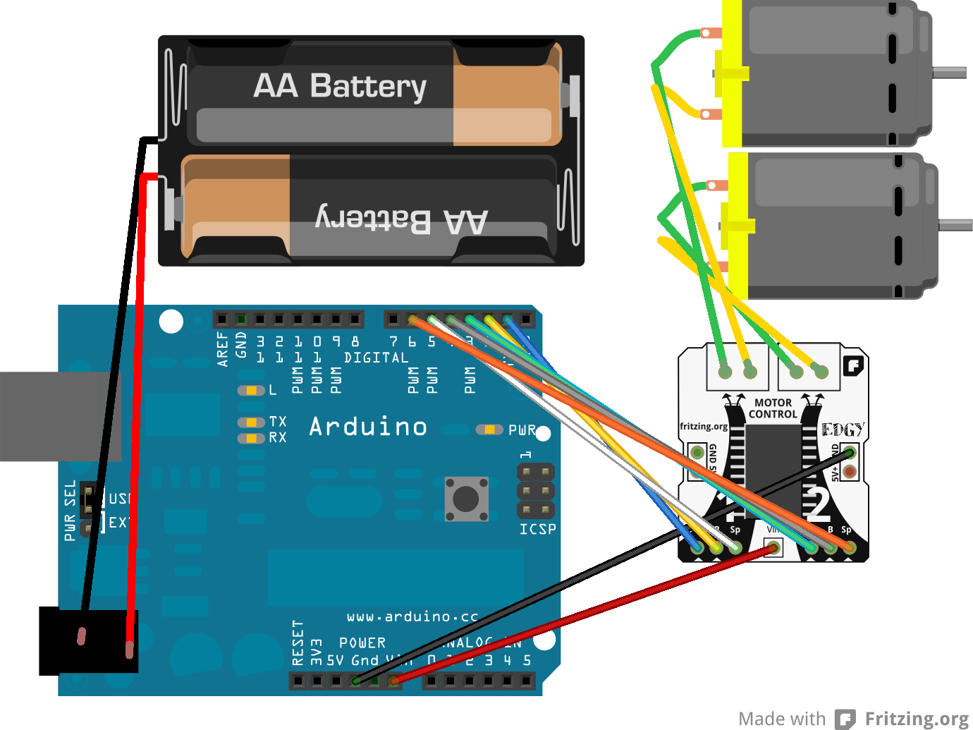

I have bought the following motor shield: http://cgi.ebay.com/ws/eBayISAPI.dll?ViewItem&item=190779229320
The controller works fine, except that for one of the motors the reverse rotation doesn't work! There's a very very small movement when I do the following in arduino: digitalWrite(IN1, LOW); digitalWrite(IN2, HIGH); digitalWrite(ENA, HIGH);
For the other output, it works fine (reverse): digitalWrite(IN3, LOW); digitalWrite(IN4, HIGH); digitalWrite(ENB, HIGH);
Also for IN1 and IN2, the following works (rotate forward): digitalWrite(IN1, HIGH); digitalWrite(IN2, LOW); digitalWrite(ENA, HIGH);
Only for IN1 and IN2, the reverse rotation doesn't work. :( Any ideas why?
Thanks a lot!
Best regards, Bence
Either there's a faulty connection somewhere or part of the driver chip has been toasted or your code is broken (but we cannot tell as you haven't posted all of it)
I'd first check you've set all the pinModes correctly, then a careful visual inspection of the whole setup - including the the motor shield for any visible signs of faulty manufacture (dry solder joint perhaps).
See attachment for wiring (the motor shield is slightly different, but has the same pins).

Thanks! :slight_smile: I have inspected the shield, doesn’t show any visible sign of bad soldering.
Does sound like its dud - check the diodes for that motor maybe? They are easier to replace than the chip(!)
