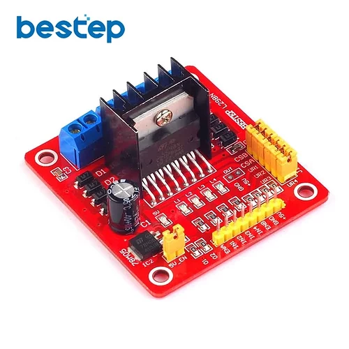

Do you have the jumpers removed from the enable pins on the L298 and are the Ena, Enb wires connected to the correct L298 pins?
<div class="post-metadata">
**Author:** ![tux\_da\_penguin](https://avatars.discourse-cdn.com/v4/letter/t/f1d935/32.png) [@tux\_da\_penguin](https://forum.arduino.cc/u/tux_da_penguin)\
**Post date:** [January 27, 2024, 5:39pm UTC](https://forum.arduino.cc/t/motor-speed-difference-using-l298n-motor-driver/1216635/11 "2024-01-27T17:39:49Z")
</div>
I haven't removed anything and yes the wires are connected to the right pins im using this specific motor driver

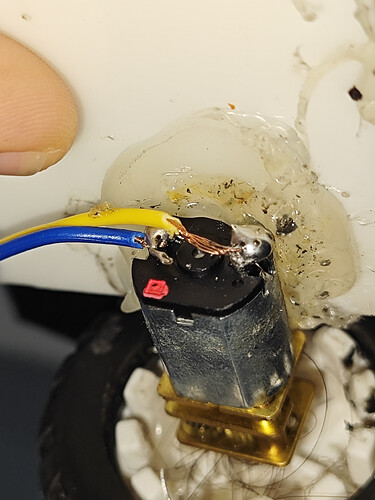

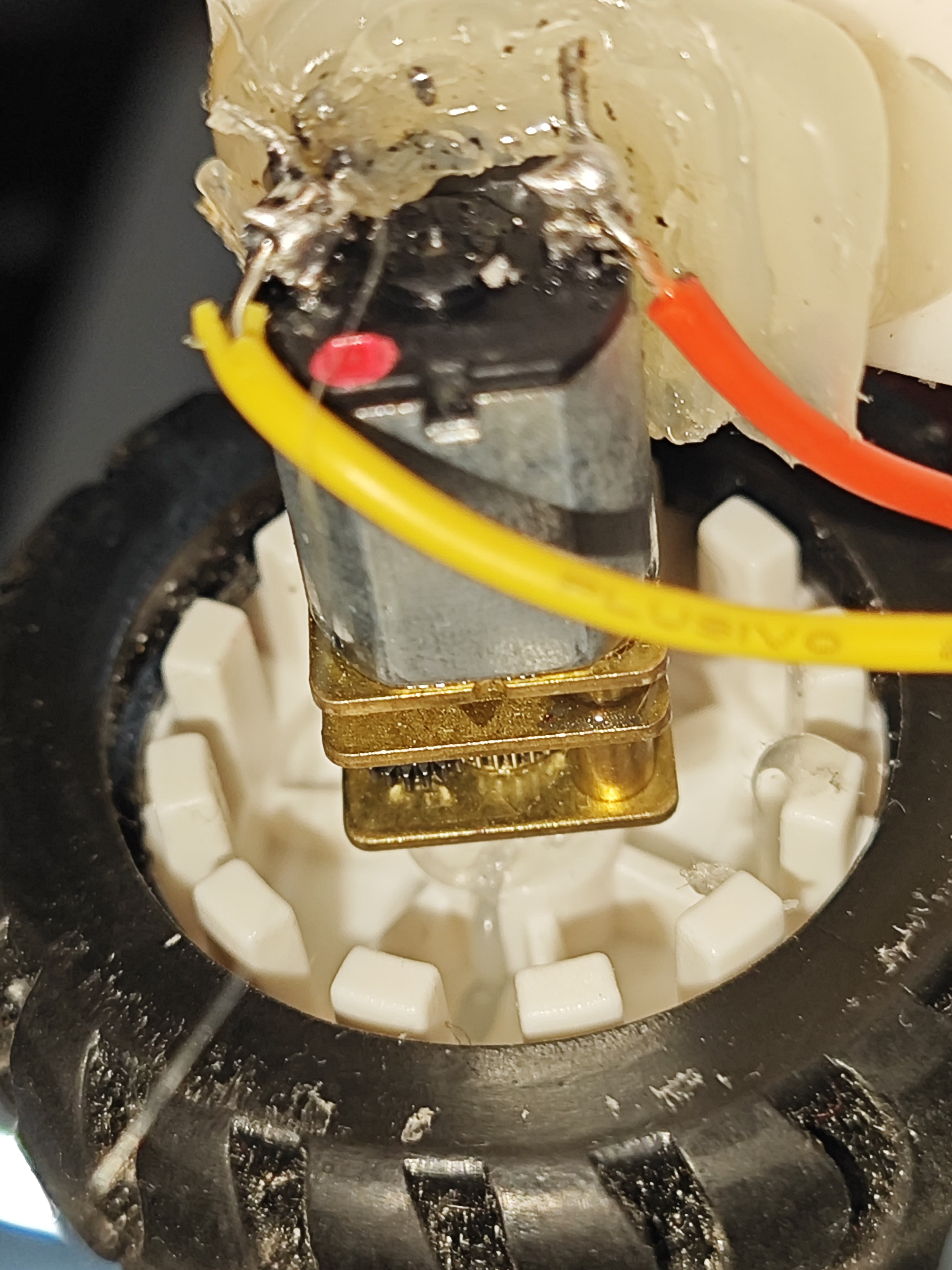

**Author:** ![anon94801460](https://avatars.discourse-cdn.com/v4/letter/a/278dde/32.png) [@anon94801460](https://forum.arduino.cc/u/anon94801460)\
**Post date:** [January 27, 2024, 6:06pm UTC](https://forum.arduino.cc/t/motor-speed-difference-using-l298n-motor-driver/1216635/16 "2024-01-27T18:06:18Z")
</div>
Hand drawn is preferred. Tutorial here: [How to Read a Schematic - SparkFun Learn](https://learn.sparkfun.com/tutorials/how-to-read-a-schematic/all)
Poor soldering can also cause problems. If you soldered joints, post a close up, focused picture showing those.
**Post date:** [January 28, 2024, 2:55am UTC](https://forum.arduino.cc/t/motor-speed-difference-using-l298n-motor-driver/1216635/17 "2024-01-28T02:55:12Z")
</div>
![IMG_20240128_104959](https://europe1.discourse-cdn.com/arduino/original/4X/b/f/8/bf885dfe300380a1b22c9adf66df78fd5cb46248.jpeg)
 ![IMG_20240128_095011.HEIC](https://europe1.discourse-cdn.com/arduino/original/4X/5/9/5/59596403ba3aa48183249df67591717a87fcb563.jpeg)
 ![IMG_20240128_094925.HEIC](https://europe1.discourse-cdn.com/arduino/original/4X/7/4/c/74c1d699ab99da0b9e7f2da3602f509cb44c6240.jpeg)
I am almost certain that soldering isn't the issues ive tried 3 different sets motors and same kind of problem

The soldering is a mess, and you may have overheated the plastic motor endplate supporting the brushes, causing them to be misaligned.

> [@tux\_da\_penguin](#):
I cannot reconcile that statement with this
 ![image](https://europe1.discourse-cdn.com/arduino/original/4X/e/6/b/e6bdd8f60d564e97d4598b98b1349117885fe480.jpeg)
