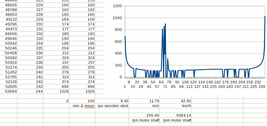

I used an Arduino Uno screwed on MTS and connected to my Laptop for doing the measurements:
First I did let interrupt service routine (ISR) directly write millis() and count to Serial because I tested such an operation taking roughly a hundreth second and my measurements are expected to be in low 2-digit number range of interrupts per second. Later, in order to avoid timing problems, I just did "A[cnt++]=millis()" in ISR and called a service function printing out the whole array after test completed (I did all using bitlash command shell).
The first run I did was successful but did not reach >40km/h speed I expected:
Checking everything I found the easy explanation, I did only use 3 LiPos giving >12V for the 15V motor: https://www.youtube.com/watch?v=Ql6ld0xTu5Q
The second run was successful as well and did show 42.17km/h, with a minimum of 105ms per 1.23m round for the wheels:
The 0 measurements are just some double interrupts at same millisecond, and the one delta measurement of 212ms at 107th interrupt was just a missing interrupt while brazen piece moved through the sensor. https://www.youtube.com/watch?v=A5BWdqNysC4
All measurements I did were done with the 20mm 1-piece Lego wheels I used until now and the 15V motor. I did find some bigger wheels in the big Lego box from my kids (they are too old to play with it anymore). I was interested in 24mm and 30 mm.

So here are my questions: 1) I have no explanation on the few peaks >800ms delta. What could be a reason that sensor does not trigger for several rounds? [In this posting I have shown that the sensor can easily generate 93.4 interrupts per second, and here we are talking on rougly 10 interrupts per second]
2) What can be an explanation on the 24mm diameter charts not showing the long minimum the first two 20mm diameter charts above do show? [Its the same motor and LiPos, just bigger wheels]

Hi, Hermann, mate. If I produced graphs like that at uni I would have been shot. Please name your axes and units, what are you graphs of?
Tom.... :) Sorry but they don't mean anything to me.
Ok, ok, vertical axis is milliseconds between two successive interrupt triggers, horizontal axis is just interrupt count. As said "A[cnt++]=millis()" executed by Interrupt Service Routine just stores milliseconds after Asuro Uno boot into an array, one entry for each.
The brassed piece going through infrared speed sensor forks is 1cm wide. Given a speed of 12m/s and ignoring the minimal difference of straight line and arc on brasssed piece that goes radially through center of sensor in forks gives 1/1200s = 0.83ms time the sensor can trigger. Not sure if that can be a reason.

The "use digital pin with jitter suppression" of infrared speed sensor did remove the "0" delta entries in previous charts.
My previous comment suspect that 0.83msec of brassed piece might be too short time for triggering infrared speed sensor interrupt was correct ! I did increase the time by a factor of 2.5 in attaching a 2.5cm brassed piece tangential on to of the existing piece (again with superglue):
Here you can see that chart curve looks good now, no spikes anymore!
And this is first time measured new speed record of 13.6m/s or 48.9km/h:
(with axis labels as requested by Tom)
The last open question is why high speed only happens from 69th til 76th interrupt (less than a second in total), then goes up to 116 (117th interrupt) and then down to 108 again -- maybe that is a sign that wheel cannot keep road contact the whole time?

It was to find out how long 4 fully loaded 160mAh 25C Lipos (4.13+4.14+4.19+4.20=16.66V) can make 147g Arduino robot run on its radial course.
The main part of the video besides start and end is not that interesting (robot runs and runs and runs), but is proof that this is no fake.
https://www.youtube.com/watch?v=5O_qYfm3O9A&feature=youtu.be
In total the robot did 3450 rounds of 1.34m which is 4623m in total(!), and that in 5:26min wich is 14.17m/s (more than 51km/h or 31mph) on average.:
30723 0
31268 1 545 2.46
357018 3450 644 2.08
3450*1.34 = 4623.00 m
3450*1.34/(357.018-30.723) = 14.17 m/s
(357.018-30.723) = 326.295 s
The high speed part from reaching 17.18m/s the first time to just before going below 14m/s the first time lasted 4 minutes with 15.82m/s on average:
40927 94 78 17.18
279354 2909 95 14.11
(2909-94)*1.34 = 3772.10 m
(2909-94)*1.34/(279.354-40.927) = 15.82 m/s
(279.354-40.927) = 238.427 s
Evaluation details and time/speed graph can be found here:
https://stamm-wilbrandt.de/en/youtube/N_24_16.66V.long.png
The robot stopped with still 1.35+2.94+3.55+2.97 = 10.81V left. As you can hear in the video Uno gets reset (an initial pause of 1 second from sketch and then you can hear the motors) again and again. While 10.81V is definitely enough to power the Uno on the robot, the two motors take too much away for the Uno to work.
At the bottom you can find the sketch (based on this posting) I used on the 2nd Uno (outside of MTS) connected with the infrared speed sensor and doing the interrupt measurements. The recording was restricted to 300 unsigned short values for interrupt timestamps (because of 2KB ram size of Uno). Using unsigned short gives an overflow each 65 seconds. What is worse for the current run is that interrupts occur every 80 milliseconds. The 300 values would be filled after 24 seconds already, not good for a long run.
So for this run I replaced the 2nd Uno with an Arduino Due and this little code change:
$ diff userfunctions2.ino ../userfunctions2due/userfunctions2due.ino
3c3
< unsigned short A[300];
> unsigned long A[20000];
The miilliseconds get recorded correctly [with overflow after 49 days ;-) ]. And 20000 values allow for more than 26 minutes recording with 80ms between interrupts.
The sketch is based on bitlash which is cool for all Arduinos besides Due, because it has some bugs for Due only and they have not been fixed in the last years. Luckily below sketch is not affected by any of the existing bugs.
The 80KB of memory for the recording array is no problem for Due's 96KB ram. Why an array for recording and not directly writing out over serial? I don't want to miss interrupts. The interactive bitlash commands added to bitlash are "re" for resetting the measurements, "ra" for reading how many measurements were done, and "sz" for printing out the whole array with value and index per line.
Hermann.
