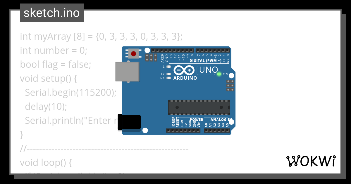

This could be the frame for the sketch: Scatter In Array - Wokwi Arduino and ESP32 Simulator
(note to others: I understand what the scatter function should do, but I did not put it in code)

It's not even an Arduino?
Whaaaa?
rewriting under arduino is not so difficult, there is no board at han
