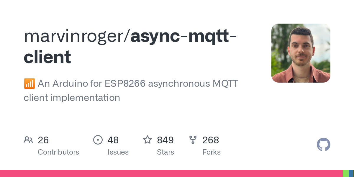

i read somewhere that i need to use this library:
