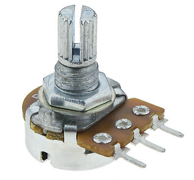

Re/ a 10k pot, will this be OK:
> **[Range of Mono Linear / Logarithmic Splined 16mm Potentiometer Pot | eBay](https://www.ebay.co.uk/itm/Range-of-Mono-Linear-Logarithmic-Splined-16mm-Potentiometer-Pot-/281705182354?var=&hash=item4196eff492:m:m4wCGal-N4R0oIjxpzHljHg)**
> Range of Mono Linear / Logarithmic Splined 16mm Potentiometer Pot.
Linear or logarithmic?
I am not considering any alternatives to MSF but thanks for the thought.
Riva - thanks for the code.
<div class="post-metadata">
**Author:** ![PaulRB](https://dub1.discourse-cdn.com/arduino/user_avatar/forum.arduino.cc/paulrb/32/216330_2.png) [@PaulRB](https://forum.arduino.cc/u/PaulRB)\
**Post date:** [June 27, 2017, 6:11pm UTC](https://forum.arduino.cc/t/msf-clock/466148/14 "2017-06-27T18:11:46Z")
</div>
That pot would work fine, but it's a bit big & bulky for the job. A "trimmer" or "trimpot" is appropriate. You won't need to adjust it very often, so something you can adjust with a small screwdriver. (Unless you plan to make the circuit battery powered, in which case the lcd may well be a mistake anyway).
 ![s-l300 (5).jpg](https://europe1.discourse-cdn.com/arduino/original/4X/7/6/3/763f60d4fe69905445f7aae4b57ae140da4f4a62.jpeg)
Log pots are generally only used in analog audio circuits. Linear pots are what's usually needed for Arduino projects.
