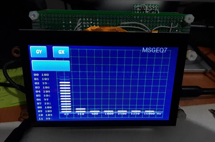

The msgeq7 datasheet indicates that the typical clock rate value on CKIN is 165 kHz, with 33pF/200k.
However, it indicates two more values: minimum = 145 kHz and maximum = 180 kHz
For the typical value of 165 kHz in CKIN, the bands are 63 Hz, 160 Hz, 400 Hz, 1 kHz, 2.5 kHz, 6.25 kHz and 16 kHz
With that basis, you can play with the values โโof C and R connected to CKIN.
In the most recent review of the sparkfun msgeq7 shield, there is the correct circuit, I replicated it with SMD resistors and capacitors and it worked the first time, especially there is a response in the 63 Hz band.

In my more recent replies in this thread I might have been too fixated on the MSGEQ7. That datasheet is where I based my original circuit on from my first post. There are some obvious mistakes in the schematic I posted but the intent was to replicate the circuit you linked to. The clear difference being that I was using a MAX9814 as my input signal vs what seems to be an output from a 3.5mm jack. My first post has a video of the results from testing with a 200k and 33pF on the CLK pin. I had 3 MSGEQ7s and they all acted in the same fashion. I may have a bad batch of MSGEQ7s but they do work at 175k and 33pF on the CLK pin. You can see my testing in this post. In this video, you can see how my 63Hz signal does work when connected directly to the computer's headphone jack:
