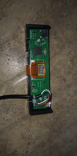

anyways, heres how the MCR looked like when i opened it
 ![bcf24ac1-7e04-4505-a54c-6b0633bc6034photo](https://europe1.discourse-cdn.com/arduino/original/4X/a/3/6/a36236df63556e9a2b67b16f68322f7760dd32ef.jpeg)
 ![5f7dce3e-e14f-4a4a-81a4-5bff4e4e1da0photo](https://europe1.discourse-cdn.com/arduino/original/4X/3/9/4/3945bf93560736b08c958c056268df09b023b2ea.jpeg)
u can see those 4 wires, which u guys said I can't connect to the arduino directly if im correct. i have so many questions in my mind right now😭
other people are saying i should use a UART, usb host shield, or cant i just directly connect usb wires to Arduino.
im gonna research more if i fo have, thank u for the replies. 😄😄

If it is USB, then you need a USB Host to connect it to. Simples.
> [@newtoarduinoworld](#):
They are saying that it would be easier for you to use a reader which has a UART interface.
For the USB to work, it has to be plugged into a USB Host socket.
