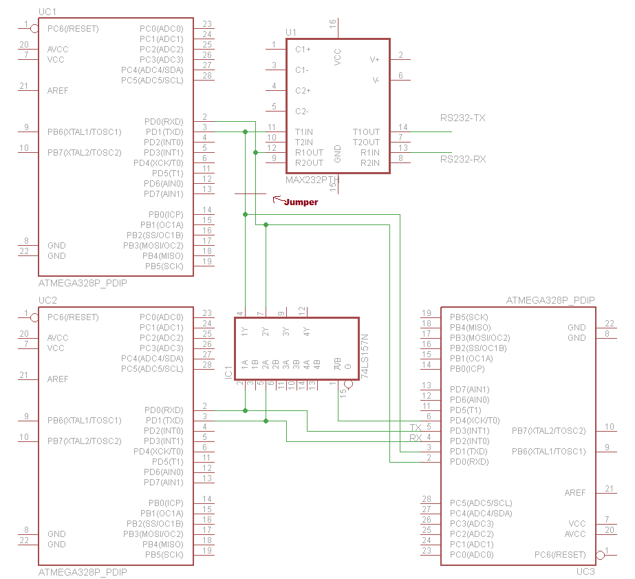

This may have been discussed before, but I couldn't find anything by searching google, I may not have been using the right keywords.
Please give your thoughts on the attached communication situations:
Questions on my mind:
-How will the MAX232 act when it gets TX signal on the ROUT pin?
-How will the uC's act when TX signal from one uC is on the TX pin of the other uC?
Goals:
-Normally the top and bottom uC's should communicate, the top and RS232 should be able to communicate.
-The operating params able to be changed on the top uC via RS232.
-The operating params able to be changed on the bottom uC via RS232.
My third sch should solve this... As long as the questions above aren't an issue??
Both uC's use a completely different protocol(of waits and characters) to enter command mode.
I should note I can NOT change the firmware on the top or bottom uC, I CAN on the right and the RS232.
Idea in third sch:
When the correct command mode sequence is recognized by the right uC it can control the multiplexer to reprogram operating params on the bottom uC that were given to it by RS232. All other times it will work as stated in the goals.
Should mention the multiplexer chip will really be SN74LV4052A. I only used the one shown for an easy way to communicate my goal... Or a MAX399 but they are pricey.
Thanks

You can't have two TX's connected, they will interfere with each other.
What you can do is add Serial.end(); after transmitting, and pinMode (TXpin, INPUT); so the pin is not interfering with the other transmitter. Not sure how you'd coordinate that, or if you have access to the right 328P's code to do that.
After that, hardware muxing makes sense.

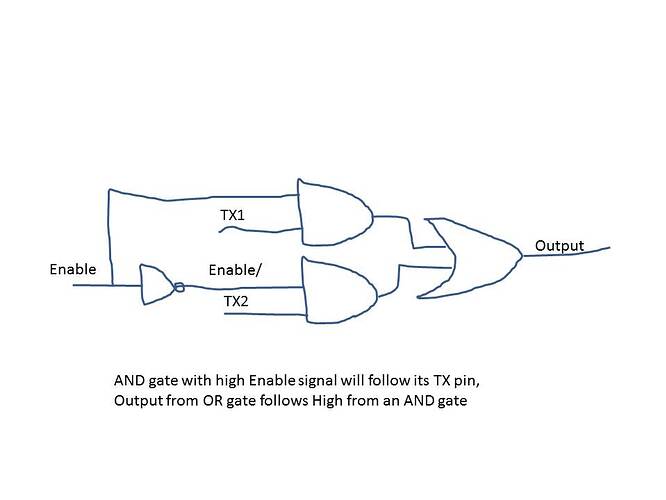

Can do with 2 AND gates and an OR gate, and one NOR gate if you want just 1 select line:
The Serial.end();/pinmode would be an option. I will be writing the code on the right 328p for the sole purpose of being able to change operating params on the bottom uC. Thanks for the idea.
I see how the gates would work also, I have found a couple sch with that set-up. The problem I have now is that I already have the completed original boards so I cant add components... So when the right 328p is transmitting to the MAX232 I have no way to isolate the TX line of the top uC. I have read that adding a 4k7 pull-up resistor to the line might help with the issue??
Thanks Again
Pullup will not help. The uCs will try and hold the level commanded in their respective output registers.
If one wants high, and one low, it will not turn out well.

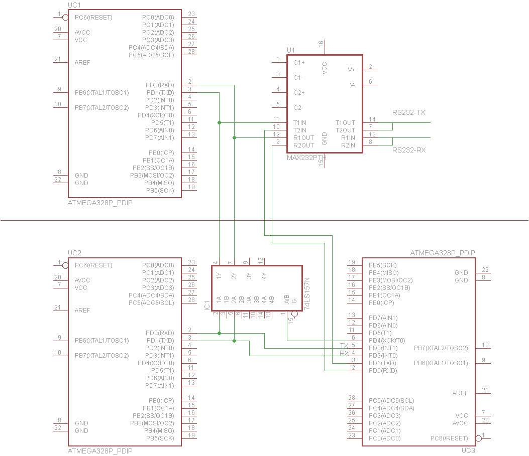

If I were to have the original boards remade with two extra pins(tx, rx) in the header/board interconnect. Would the attached make sense for my objectives?
The bottom uC is actually a bluetooth module, on the new sub-board. The original board should run with or without the sub-board but I need to be able to change the params on the bluetooth module via UART.(this info may help understand what I'm trying to accomplish)
I may be better off just buying a BT that is capable of "overair" AT commands.....
Output from Rs232 can go to inputs on all 3 uCs.
Only 1 TX should be connecting to th RS232 input at a time.
How are you turning the top one off?
You need to control G on the LS157 so you can turn the bottom 2 off.
I think you've got the idea, just think thru the path of the signals some more.

Maybe I should look at taking the right 328p out of the picture again, but then I don't have programmable logic to control the gates... The second picture shows the talk paths without the 328p, I will check the datasheets and see if they have a "Enable" output pin for UART transmit..??..

No chance of non-interference. RS232 does not have output enable, can't be turned off.
These are thru hole parts? You can straighten pins out, add parts dead-bug style and add wires.
Ugly, but gets the job done.
