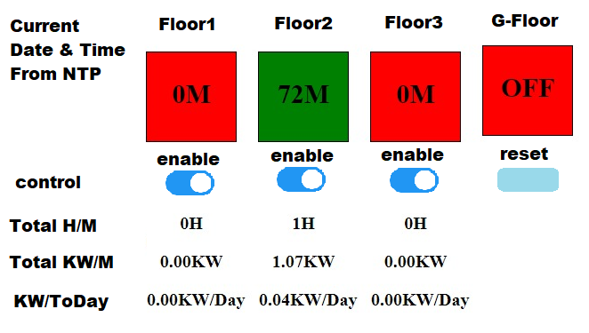

can you explain in detail what the "webserver" should do?
web server should show 4 Relay status as 4 squares in one line so that off Relay displays in red color and on Relay in green color
Also display total on time for each led under it in bold big black font
how should it show 4 status if you only have 3 relays?!?

You can't access privat or protected member variables. You need getter for that.
I have rolled back to my previous class because you have deleted to much.
Thanks very much it works fine but the page is not updated until you manual update with f5
and the time calculated only when you manual update ( I mean if you do not update manually while button is pressed then its state stay red and calculated time is 0, when update manually after button released that state still red and no time calculated )
can you please modify the code to calculate time if page updated or not, and fix page to automatic update, also I need to add one square status for
"const uint8_t commonStatePin = 5" with no time inside.
well, that is a new requirement, you didn't state that in your post #64 and is neither in your code.
For sure I could but why don't you do it on your own?
start with the additional box for the common State Pin.
if you have that working and want to make the automatic update working you should search for "Fetch API" and JavaScript and JSON.
here I have a generic webserver which includes some of this technics.
https://werner.rothschopf.net/microcontroller/202108_esp_generic_webserver_en.htm
If I were you I would transmit each relay state and each relay runtime in the JSON and use the JavaScript to update the fields on the page.
Take your time.
If you need further help, post your code so we can see how far you got.
Ok you are completely right so I modify the code and added additional box for common State Pin
and set automatic refresh for the webpage each 5 sec.
I fail to modify code so that Total run time continue to calculate even web page is not refreshing
this is my modified code
  https://forum.arduino.cc/t/multi-button-programming/1094488/

I try to add a new button to web page for reset runtimetotal
but I get a lot of erros
Also I add function printLocalTime() to read time and date from ntp for adding a new line in webpage for divide
"String(indicator[i].getRuntimeTotal() * 0.888 / (day of the month*3600.00)"
for each relay but I can not complete it
And I want to shift the contents of webpage to right to add a text description before each line
for example add "Floors" before squares line and add " Total Hours " before second line and so on
I need some help to fix these

Ok I done no. 2. divide by a day of month
and this is the web page I want to reach

Now if possible help to modify web page and add reset button to reset RuntimeTotal to 0
other 3 swiches I work on them the idea is to set button to high when disable.
imho you have a table now:
This should be straight forward. Or do you see any reason why this should be no table?
two questions regarding:
    if (i == 0) {
      html += "<p style='text-align:center;font-size:20px;font-weight:bold;color:black;'>" + String(indicator[i].getRuntimeTotal() * 0.888 / 3600.00) + "KW</p>\n";
      html += "<p style='text-align:center;font-size:20px;font-weight:bold;color:black;'>" + String(indicator[i].getRuntimeTotal() * 0.888 / (day * 3600.00)) + "KW/Day</p>\n</div>\n";
    else {
      html += "<p style='text-align:center;font-size:20px;font-weight:bold;color:black;'>" + String(indicator[i].getRuntimeTotal() * 0.888 / (30 * 3600.00)) + "KW/Day</p>\n</div>\n";
a) why is indicator 0 handled differently?
b) I still don't get your idea of calculation of KW/day ("per day" or "this day"?!?) If you want a KW/day by using the current day you will need either the start date of the sketch (where all runtimtesTotal began with 0) or the day of the first start of an indicator. For example the sketch starts on Sunday, but one indicator is used on Wednesday the first time. If that indicator has used 1kw on Wednesday (only), what result do you want to see on Thursday as kw/day?
if you need a number "this day" you will need a separate runtime counter for the current day.
