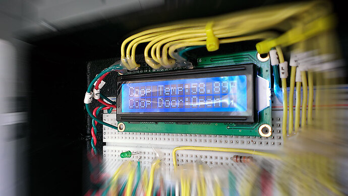

howdy,
still a bit of a noob, but i have my automated chicken coop sketch working except for the door open/close function "doCoopDoor();" (which is odd, b/c that particular sketch works fine when it is separated out from the main (multi-function sketch)
within the main sketch i have:
  • thermometer
  • heat
  • fan
  • servo for web cam
  • lcd
  • coop door
would really appreciate someone taking a look and letting me know why "doCoopDoor();" works on its own but not when embedded the main sketch. (both attached below)
also, i'm fairly certain that while i have most of the functionality working within my sketches, (and have studied/read quite a bit) it's probably done with ~newby/lengthy~ code? if anyone might be able to critique some of my noob-like habits/code, i'd really appreciate it. i'm very interested in becoming better at this and when further experienced, helping others & sharing.
thanks,
//dave
  1. the main chicken coop sketch: (with the coop door function included , but currently that function does not work)
  2. the coop door function alone (which currently works)
    ~both attached~
naves_family_chicken_coop_controller.ino (16.7 KB)
L298N_Motor_Controller_10_6_photocel_millis.ino (8.63 KB)

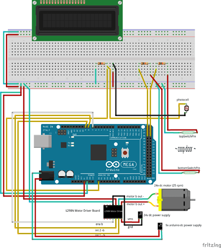

since i've had more than a few fellow chicken coop/arduino enthusiasts msg me and ask how this project was going, i thought i'd update this post with solutions and resources.
i finally got the door working exactly as i wanted it. works flawlessly and not hard to understand.
key points:
  • i found a cool timer library "simpleTimer" which, after dealing with too many millis functions, this allowed me to have 1 ref and then call it with different timings
  • after testing many different methods, i chose to check the photocel readings every ten minutes, then check the reed switches and only then turn on/off/stop the door motor. (this was also helpful in dealing with chickens that didn't come in right away and got locked out. (ps. i've found that it's better to NOT lure the girls in with a light as the ambient light shines outside the coop and keeps them outside longer)
anyway, the final code attached and fritzing diagram linked below.
all i ask is that if your use any of my code or ideas, that you share your progress with me and the rest of the world - i'm big on sharing -hey, it's open source.. makes the world a better place, yes? =)
fritzing diagram:
note:
i've been building the coop (el pollo palace) on and off now for about a year and have just started documenting everything on my personal site. (just been very busy with work) it's a work in progress with much left to do, but please take a look and let me know what you think. (there's a whole section on what i did with the door - vids, pics, code & diagram)
:slight_smile:
here's a link to the coop door project: (pics, vids, diagram, parts, & code)
http://davenaves.com/blog/interests-projects/chickens/the-coop/arduino-automatic-chicken-coop-door/
here's a link to the main coop project (again - much more to document, but maybe it'll give some ideas)
thanks again for those forum members who helped me here!
cheers,
//d
doCoopDoor.ino (8.53 KB)
finally found the img embed tool. =)
The Fritzing Wiring Diagram for the Automatic Chicken Coop Door
cheers!
