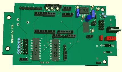

The Print:
(my first doublesided print, was a mess to get it aligned...)

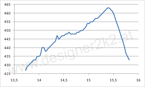

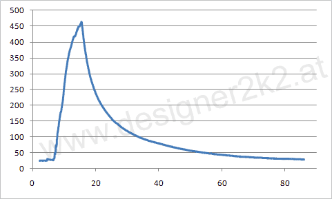

i played a bit with the thermocouple readings:
(its in °C and Seconds, thats heating up a thermocouple with a lighter)
and a zoom into the peak:
its quite fast, around 30Hz when using only 2 channels. And surprisingly low at noise!

There is the RPM print now directly on it, so it has 194pins (from the 250 pin max in the free version from Target)

What program does everyone use to do this?
Thanks
Btw, project's just getting better and better. I'm keeping an eye on this topic...
Mowcius
what Programm you mean? for the Layouts? Im using Target (http://www.ibfriedrich.com/)
i think more common here is Eagle for layouting...
If the picture's not working then I meant how do you do the 3D board thingies :smiley:
Mowcius
yeah thats target, has this build in :slight_smile:
see here: http://server.ibfriedrich.com/wiki/ibfwikien/index.php?title=3D-view
Yeah, we use eagle cos it's free. That looks cool but I'll have to pass cos i'm a tight arse... :smiley:
Mowcius
Target is also free, but limited to 250pins. thats enough for me :slight_smile:
