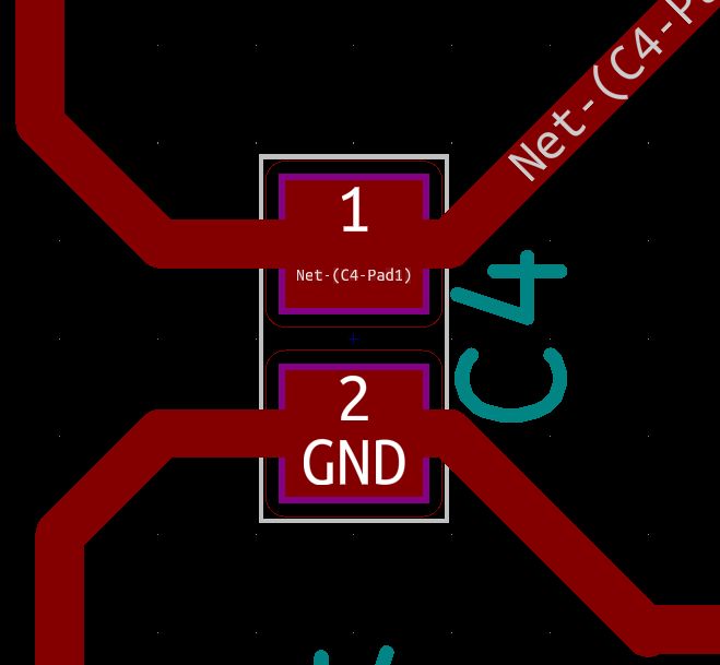

Mike,
Although were getting into minutiae here (for hobby circuits), the following are some guidelines:
SMD parts are better at filtering very high frequencies than the leaded versions.
Wiring of the capacitor is critical. For the high frequency parts, ideally one would like the input on one side of the pad and the "output" on the other side of that same pad. (see screenshot)
This general philosophy should be followed on breadboards as well.
The push in lead type breadboards are not very good for high frequency connections.
