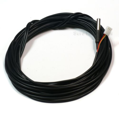

Have you trawled up previous discussion on this matter? One of the great things you get to quickly learn about Arduino is that, no matter what your problem is, that chances are pretty good that somebody else has had it too. I'm sure people have gone well over 10m with CAT5 cable, so all of his can't be hard, for chrissakes, but, before you get blinded by science and double schottky-diodes, maybe a solution lies here:
> **[10M Waterproof Digital Thermal Temperature Temp Sensor Probe DS18B20 Connector...](https://www.ebay.com/itm/10M-Waterproof-Digital-Thermal-Temperature-Temp-Sensor-Probe-DS18B20-Connector-/231022533385?pt=LH_DefaultDomain_0&hash=item35ca041b09)**
> Find many great new & used options and get the best deals for 10M Waterproof Digital Thermal Temperature Temp Sensor Probe DS18B20 Connector at the best online prices at eBay! Free shipping for many products!

> Newmill:
> ....I'm using the sensor (waterproof) itself. .....
I used a couple of those too, (not sure its the same) but it seems they had resistors in the metal casing.
I was able to hook them up to a couple meters of cable without resistors and they worked fine.
<div class="post-metadata">
**Author:** ![Nick\_Pyner](https://avatars.discourse-cdn.com/v4/letter/n/e8c25b/32.png) [@Nick\_Pyner](https://forum.arduino.cc/u/Nick_Pyner)\
**Post date:** [July 27, 2014, 11:49pm UTC](https://forum.arduino.cc/t/multiple-ds18b20-on-a-10meter-long-cat5-not-discoverable-help/245636/20 "2014-07-27T23:49:19Z")
</div>
> Lennaert:
I don't think there would be any pull-up resistor in the casing unless the supplier explicitly advised that.
