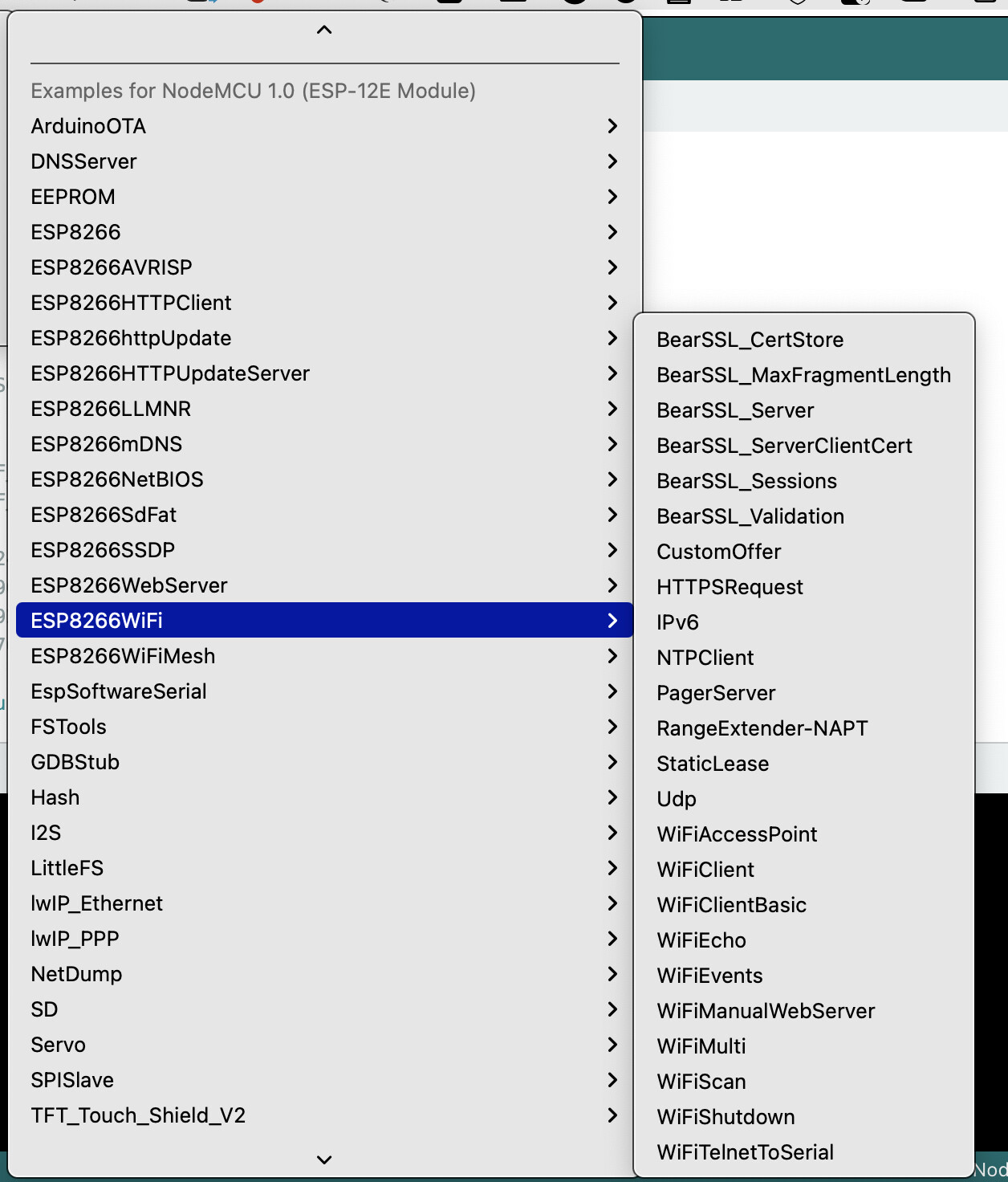

The sample code for ESP32 and ESP8266 has what you need.

You have many options like mentioned already here. Having one client or four doesn't really change anything.
Pick some quality tutorial and choose communication method.
you have several options for example UDP, TCP or HTTP and I suggest you read my general summary in a first step:
As you mentioned that your ESP32 should run a webserver anyway I would chose HTTP as protocol and set up a HTTP Client on the ESP8266. You just need to transmit the data as key value pairs from the client to the server and extract the transmitted data with some simple functions of the HTTP Server.
here I have example sketches with should work together as Client -> Server.
