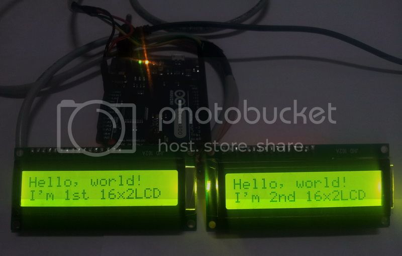

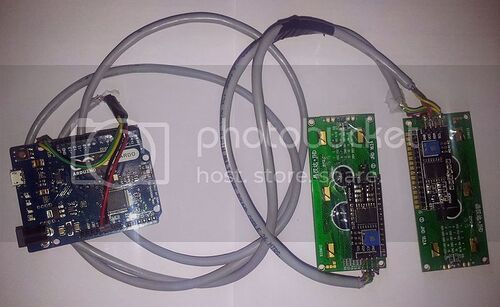

Have successfully connected
2x i2c piggyback - IIC Module
coupled with
2x 16x2LCDs - JHD162A
to Arduino Leonardo.
Installed this i2c Scanner sketch, connected the i2c LCD individually to Arduino Leonardo & noted each i2c address through Arduino IDE Serial Monitor - Arduino Playground - I2cScanner
Both i2c piggybacks had the same address 0x27.
Changed one piggyback's address by shorting A0 pcb pad (among A0, A1, A2) to get 0x26 . Did not use pull-up resistors since internally these piggybacks have 4.7k resistance. Connected the Vcc, Gnd, SDA & SCL in parallel to both i2c LCDs. Length of the cable is 1m from Arduino.
Used F. Malpartida's LCD library - https://bitbucket.org/fmalpartida/new-liquidcrystal/downloads
Test code:
#include <Wire.h>  // Comes with Arduino IDE
LiquidCrystal_I2C lcd1(0x27, 2, 1, 0, 4, 5, 6, 7, 3, POSITIVE);
// Specify the 1st I2C chip address used for 1st LCD & its connection pins
// (addr, en,rw,rs,d4,d5,d6,d7,bl,blpol);
LiquidCrystal_I2C lcd2(0x26, 2, 1, 0, 4, 5, 6, 7, 3, POSITIVE);
// Specify the 2nd I2C chip address used for 2nd LCD & its connection pins
  lcd1.begin(16,2);   // initialize the 1st lcd for 16 chars 2 lines, turn on backlight
  lcd2.begin(16,2);   // initialize the 2nd lcd for 16 chars 2 lines, turn on backlight
//-------- Write characters on the 1st & 2nd displays ------------------
 // NOTE: Cursor Position: (CHAR, LINE) start at 0
  lcd1.setCursor(0,0);
  lcd1.print("Hello, world!");
  lcd2.setCursor(0,0);
  lcd2.print("Hello, world!");
  delay(2000);
  lcd1.setCursor(0,1);
  lcd1.print("I'm 1st 16x2LCD");
  lcd2.setCursor(0,1);
  lcd2.print("I'm 2nd 16x2LCD");
.....edited on 4th Nov '15 as per floresta's following remarks of incomplete code description.

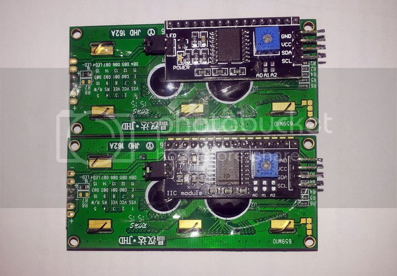

To clarify -
The i2c piggyback I received uses PCF8574T chip.
This is how I changed the i2c address. Bottom one is the unmodified piggyback with i2c address 0x27. Top one is the modified (A0 pad shorted) with changed i2c address 0x26.
Guess without these A0, A1 & A2 pads it would be difficult to manipulate individual I2C addresses.
