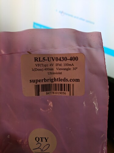

Can you tell us where you got the LEDs from and how do you know they are 100mA?

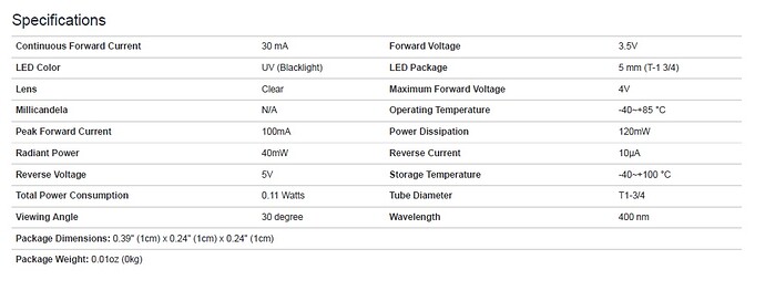

The manufacturer's data says that the continuous forward current is 30mA, and forward voltage is 3.5.
Since you can't supply more than 20mA from an Arduino data pin, they may not be as superbright as you expect.
The resistor calculation is (5-3.5) / 0.02 = 75 ohms.
I wonder if the OP is getting confused by the peak current rating of 100mA? Peak current is only for very quick pulses if you try and run an LED at that current for longer than a mS or so it will burn out. Note it says
Peak Forward Current (1/10th duty cycle, 0.1ms pulse width) IFM 100 mA
So that is like a parking sign that says one hour no return for three hours, only it is turn it on at 100mA for 0.1 mS and don’t turn it on again for at least 1mS.
UV LED specs, 3.5V 30mA, 100mA peak forward.
Tom... :slight_smile:
