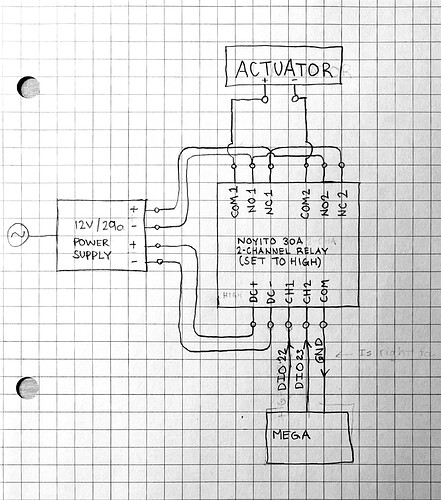

To control power and direction of the actuators I am considering two options. One would be to use a 2-channel relay unit - something like this NOYITO 30A 2-Channel Relay Module. relay spec. Wired in this manner for one actuator:
I would draw from the LRS-350 to power the relay, but I'm not sure the way I'm doing it is safe. I'm planning on making a power supply box that includes the relays that stands next to the actuators they power and control. Also, I’m still trying to figure out how to wire this up so there is no back current. How do I know if the relay module already provides back current protection? Seems like these components never have specs for the build, just for the components.

Most relay modules have a flyback diode on the relay coil. But since the control is through opto-isolators, then you have nothing to worry about.
I am not following you wiring of the actuator. Do you have the actuator in hand? Do you reverse it by simply reversing M+ and M-? How do you know when it's reached the limit of travel?

The actuator is getting input from the two COM outputs on the pair of relays I posted a link too. The wiring diagram includes the actuator, relay module, power supply, and arduino. A HIGH signal from one DIO arduino input moves the actuator in one direction and HIGH signal from the other DIO input moves it in the other direction.

How is the mega powered? As long as you only have 1 of either VCC or GND connected from Mega to relay you should be isolated, but the power supplies should be separate. Do NOT connect BOTH Mega Vcc AND GND to the relay module. You need kickback suppression on the actuator lines, either 4 1N4003 diodes on each one or 1 15V bidirectional TVS diode.

I don't like that kind of relay module, they SHOULD have a separate connection for the opto coupler common, but that would cost the mfgr another 3 cents.
@JCA34F I'm actually trying to figure out the details of the power situation and it is something I forgot to include. I plan to have the MEGA connected via USB. Will I run out of power to communicate with the relays? I may add IR sensors to the maze as well. I left that out to limit the complexity of my post. I just wanted to focus on powering and controlling the actuators right now.
I don't understand how the diodes will work with diagram I have. If I put diodes on the lines running to the actuator from the relay wouldn't that only allow the motor to turn in one direction?
Isn't there a separate connection for optocoupler common on the relay I provided a link to? On the MCU input side of the relay module there is DC+ and DC- for the relay power. Then there is the CH1, CH2, and COM. Isn't that COM running back from the optocouplers? It serves as the ground coming from CH1 and CH2 if I understand correctly.

Yes, your module DOES have a separate input COM, that's good, first one I've seen.
Shouldn't, the relay inputs only draw a few mA each.
Post that diagram.
Isn't the diagram showing in the op? I just tried fixing it.
-RG
OK, here's a cockeyed hand drawn diagram, hope you can read it, think I would go with a single TVS diode connected right at the actuator terminals if possible.
@JCA34F Thank you for the diagram. It makes sense to me. I'm learning about TVS diodes now. When you say:
Do you mean on the relay side or as close to the DC motor as I can get them? I'm trying to figure out if this protection is built into the actuator. At first glance from the documentation it doesn't seem to be.
My thinking is:
If the diode is located at the relay and the cable to the actuator is 1 meter long, the spike current will have to travel the cable and create a magnetic field that will be radiated from it.
If located at the actuator, it will be absorbed right there, less radiation antenna.
Of course, there are differing opinions.
@JCA34F I can buy that. I do want to minimize any sort of noise in the area. I'm not sure to what extent I'll have to go, I'll chase that issue if it becomes a problem. Putting a TVS diode close to the actuator wouldn't hurt.
