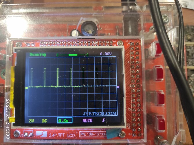

Leo, Sorry for the delay as I have only just got back to it.
I have been experementing with different delays and seeing what comes up on the oscilloscope I have manages a photo without delay of pin 0 but cannot capture with delay as my phone camera is not fast enough.
I have managed to upload to a Nano with a mini PC with the old boot loader.
With a 250ms delay I get a 200mS pulse at 5V
with a 1000ms delay a 1 sec pulse at 5v.
I am also getting a delay between pushing the button and an output. This could be that the Nano is a bit slow processing the data. I may have to go back to the Uno but was trying to save space.
I was wondering whether it is possible to latch the output as the current delay seems to increase the down time markedly.
Paul

Confused. Please explain exactly what you want to happen.
Do you want the output to stay as short as possible, independent on how long you push a button, and then return to zero. Or do you want the output to stay for a fixed amount of time, even with a very short button push.
Leo..
I would be happy if it stayed on for as long as the button is pressed. At present there is a delay before getting an output and if the button is released there is no output. The larger the delay the longer before the initial output but if the delay is too short it cycles quickly through the loopl;
Instant output on button press, and instant return to zero when released is how I tried to code it, but maybe there are Gremlins at work. Can you wait a few days, until my parts have arrived.
Leo..

microbeaut I tried your code but unfortunately it does not decode.
If buttons 0 -7 pressed output only from pin8
If buttons 8 -15 pressed output only from pin9
If buttons 16 -23 pressed output only from pin10
If buttons 24 -31 pressed output only from pin11
no output from pin 12.
This is pressing one button at a time
Paul
