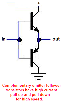

The ideal would be protected shortcut-proof drivers, like RS-485 drivers, but they are ment for 32 per net.
A RS-485 does not allow a lot of noise, but the VirtualWire (or RadioHead RF_ASK) is ment to work with mostly noise. Therefor the signal and the circuit can be simpler.
I don't know how much speed can be achieved. Perhaps only 1000 bps or maybe 200 kbps.
In the old days, a terminal with 2400 baud could have very long wires.
It depends a lot on your cables and wires, how the circuit should be build and how safe and protected against spikes it should be.
Complementary emitter followers are like this : a picture somewhere on the internet
