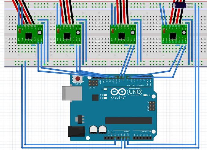

Here are my little friends:
3 Small Steppers: Small Stepper Motor - ROB-10551 - SparkFun Electronics
1 Medium Stepper: https://www.sparkfun.com/products/9238
4 A4988 Motor Drivers: Pololu - A4988 Stepper Motor Driver Carrier
Arduino Uno
These wonderful little doohickies are set up as seen on attached JPG.
My code is as follows:
#include "Stepper.h"
#define STEPSTM 200
#define STEPSM 48
Stepper TumblerMotor(STEPSTM, 12, 13); //defining the Tumbler motor function and pins
//Stepper Motor1(STEPSM, 10, 11);  //defining Motor one of three
long previousMillis = 0;        // will store last time motor was updated
long delaytm = 10;           // interval at which to spin (milliseconds)
  TumblerMotor.setSpeed(100);    //Set the velocity of Tumblr Motor
//  Motor1.setSpeed(50);          //Set velocity of Motor 1
  Serial.begin(9600);          //Setting the speed for the serial reader
  unsigned long currentMillis = millis();      //current time in milliseconds
    if(currentMillis < 10000)
         TumblerMotor.step(100);            //Steppity Step Step
/*    if(currentMillis > 10000)
         Motor1.step(100);            //Steppity Step Step
      Serial.println(currentMillis);
What I want it to do: I would like 4 motors to be able to work, either one after another or simultaniously. The large motor will eventually spin until a certain time, and then the small ones will increment in their own way.
What happens: The first motor/driver goes off without a hitch, but does get hot after a while of leaving the Power Supply connected. As for the second motor, I have 3V and 12V at the second driver, but no signal to the STEP/DIR of the driver, followed by no movement. When I attached the small motor to the first driver (with the same code), it works, but the driver buzzes after it's little rotation session and the motor got quite a bit hotter than the larger one. I haven't gotten to the 3rd or 4th yet for obvious reasons. The commented out part is the stuff for the second motor that I feel should work, but does not.
I am currently in my first circuits class and have taken electricity/magnetism, so please feel free to explain your suggestions.
I am thinking I have a bad driver... The signal thats getting sent to the second driver STEP/DIR is 1V. 0V when I turn the little screw thing on the driver. Can anyone explain what that is? I couldn't find it in the datasheet, which I'm sure includes it.

Why are you powering the 4988s with the 3.3V from the arduino ? Just power them with the 5v and then your logic signals will be correct.
justone:
It was a mistake in my diagram, they are connected to 5v. They work fine one at a time, so this would not be the issue.
I don't get this concept except for doing a delay without saying delay. I don't want to delay anything, I just want one to run after the other. If you could explain how it works for what I want to do, that would be very helpful.
BTW, The code I posted has two motors, but one is commented out.
