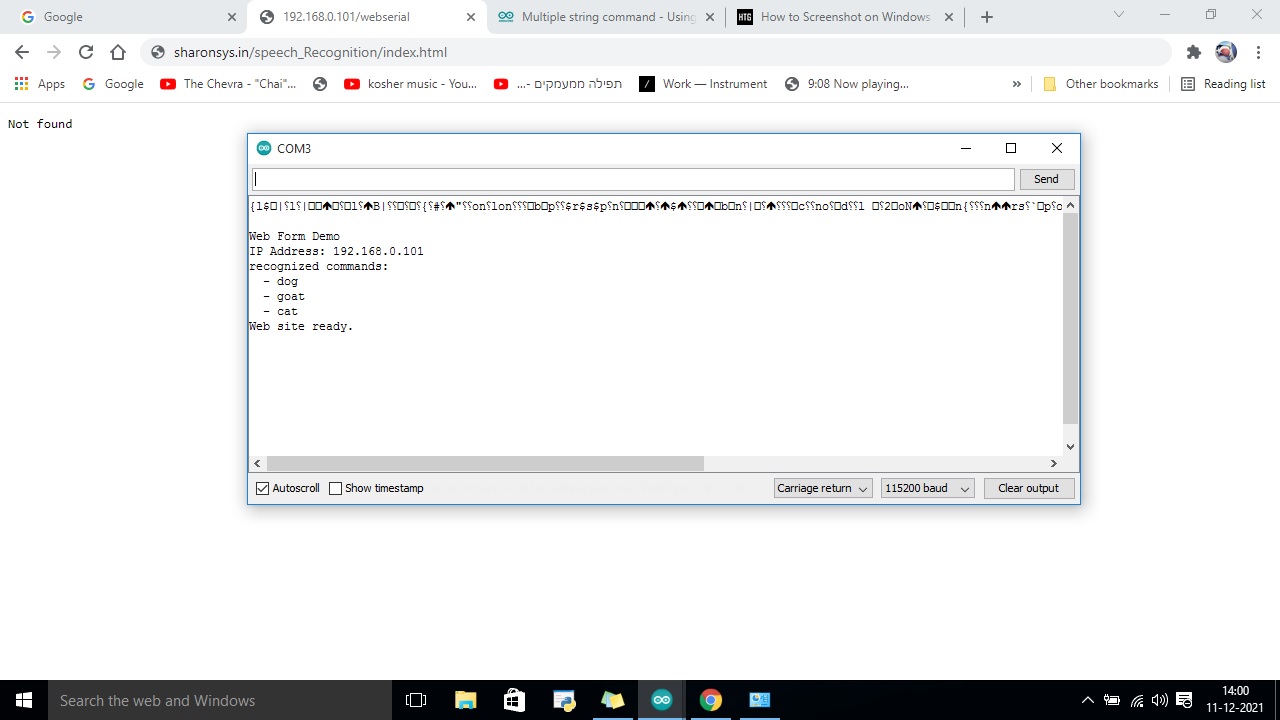

Hi
On the webpage I get' Not found'
On the serial monitor
I get response only for entering 'dog' command in the serial monitor.
then the LED dos not work
Regards
Samuel

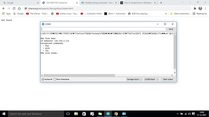

Now the webpage shows not found
but the monitor says website ready
I dont understand because I did not make any changes
The only change I made was the password for ssid
regards
Samuel
again, the code posted above does not listen to the Serial monitor, so typing anything in the Serial monitor (if this is the one of the IDE) won't do anything.
Your "not found" seems to be for http://192.168.0.101/webserial
this is not what you should type. The web page to use is just http://192.168.0.101
Use the IP you see in the Serial monitor

i used the ip that was in the serial monitor and the webpage showed not found.
what's your PC's IP address and net mask? is your PC on the same network as the ESP?
what did you type exactly?
if you don't have the web interface, how can you type anything?? I just don't get it.... AGAIN, the code does NOTHING through the serial monitor. So don't expect any input in the Serial monitor to be dealt with. stop doing that, stop bringing that up, there is no point there...
You need to get the web page working. It works on my network. If you can't reach your ESP, you need to explore what's going on from a network routing perspective.
Right there was no web page so I could not type there
I just tried typing in the serial monitor just to see if it worked like before

can you share IP and net mask ? is the PC using also the WiFi or ethernet? what URL are you typing (exactly)?
seems you can't get to your ESP so that's an issue.
serialmonitrt shows :
IP Address: 192.168.0.101
recognized commands:
  • dog
  • goat
  • cat
    Web site ready.
  • dog
  • goat
  • cat
    Web site ready.
This is irrelevant. we know the Arduino boots, joins the network and prints what's expected. All good there. (did you boot twice ?)
the issue is why your PC can't find it.
Could you answer the questions ?
I am using the same wifi as the esp
i am typing 192.168.0.101/webserial
i booted twice
what did I write about this in post #70 ??
do you read the answers? why should I bother...
