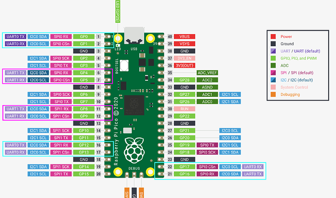

Multiple UARTs not working simultaneously on Rpi PICO
I am working with Rpi Pico using arduino IDE:
I am facing issues with different uarts of pico ( UART 1 & UART 0) not working simultaneously in the integrated code of whole system.
Basically I have used a GPS module at another UART and radio module at different UART. I tried using separately GPS and it worked, but with integrated code both uarts ( UART 1 & UART 0) not working simultaneously. I also tried different ways for debugging like checking GPIO pins of UART with actual physical pins on the Rpi Pico. I have indicated the block which has problem using this comment : /This UART block -->/
My reference of Rpi Pico UARTs : Rpi Pico UARTs

You have marked two lines in your code.
Does this mean that both lines block?
You are using a delay(1000) inside your burnWire-function
delay() is of course blocking
This way of using non-blocking timing

Yes you got the correct inference, those two block marked with this comment : /*This UART block -->*/ are not working simultaneously
I tried doing that a week ago what u said, by removing that delay in Burnwire function but still the problem of multiple UART not working is still there! So I think that delay couldn't be the reason for blocking of those 2 blocks. Obviously I agree that delay is blocking for MCU sequential tasks.
Basically these below 2 blocks are not working together in same code:

yes, When the GPS is ready to send the processed data it will communicate with mcu via serial2 and when there is some serial data on Serial2 it must execute!
I got the reference of Multiple UART with Rpi Pico from a site (Shared in my first post of this topic)
I looked up the technical specs
a Raspberry Pi pico has only two UARTs
You are trying to use three UARTS
1: serial
2: serial1
3: serial2
are you sure that
"serial" the one without a traling-digit is additional to the two other UARTs?
I have looked up the specs and the Pinout here
https://www.raspberrypi.com/documentation/microcontrollers/raspberry-pi-pico.html
This pinout shows two UARTs
1: UART0 marked with cyan frames
and
2: UART1 marked with pink frames
You can assign the two UARTs to different IO-pins but there is only UART0 and UART1
EDIT:
After reading your link
https://arduino-pico.readthedocs.io/en/latest/serial.html
serial is indeed the USB-to-Serial converter which is extra to UART0 and UART1
