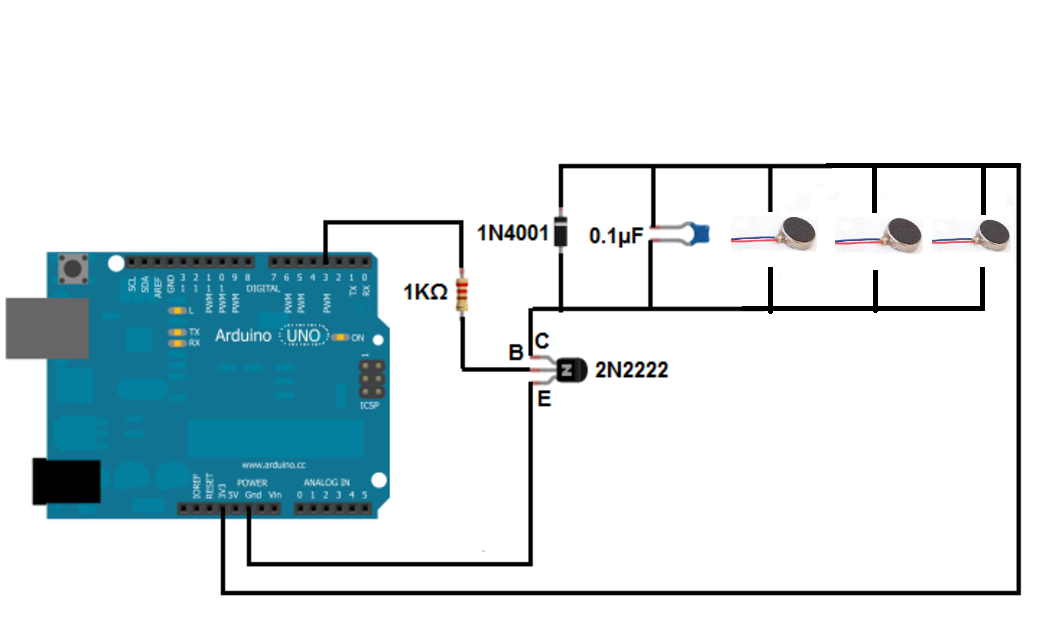

This drawing would reply to your question. I can't understand to connect module and sensor using text.
Can you show me the drawing for the connection?
Here is LED Shift register example that I found.
Do you want to individually control the motors or turn all 14 on and off at the same time? Individual control will require a 595 output, transistor, resistors, diode and cap for EACH motor. If you just want to turn them ALL on or off at the same time a different transistor is required and no shift register.

You will need an external power supply for the motors. The Arduino supply can handle 4 or 5 motors at best depending on what else is connected to the Arduino supply.
