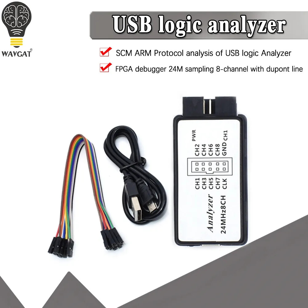

I would also getting a USB logic analyzer, the '24 MHz' are less then $10 us from china. They look like this>
