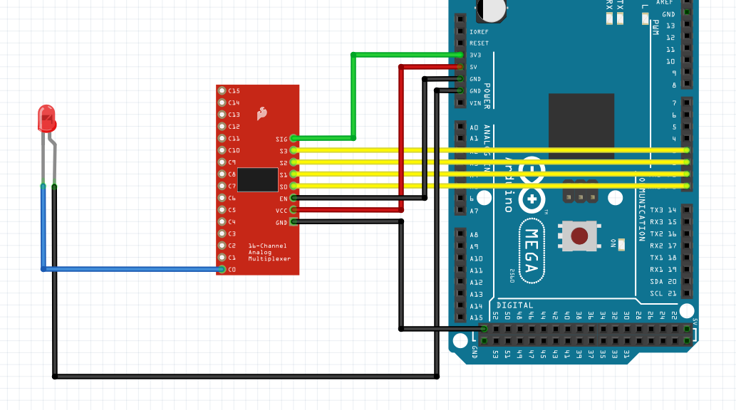

Hello guys,
I am trying to understand several things about the 16-channel multiplexer. I have found many topics on this forum and on the internet but I am still confused. Here is what I did:
  1. See attachement 1
I measured with a voltmeter the voltage between GND and S0,S1,S2,S3 and SIG. I was expected 0V but I found around 2.5V for all measurements.
  1. See attachement 2
    I sent 0000 on S0 S1 S2 S3. Then I connected the LED on C0, C1, C2.... C16. And the LED was always ON !!!
  2. See attachement 3
    The same as above...
What did I do wrong??
A 74HC4067 is a selector switch with 16 positions.
It connects a common pin to one of the 16 inputs/outputs (a switch works both ways).
Four control pins are needed to generate the binary numbers 0-15 to select the position of the switch.
If you connect the common pin to 5volt, then the selected output pin will also have 5volt on it, and the remaining pins are 'floating' (not connected to anything).
A switch of the 4067 has a rather high internal resistance, and is not designed to switch power, only signal.
A LED without current limiting is going to overload and likely fry the chip and/or the LED.
You should never use a LED without current limiting resistor. Try 1k resistors (~3mA LED current).
Try 74HC595 or TPIC6B595 shift registers if you're going to play with LEDs.
Then you can turn more than one LED on/off.
Leo..

Forget 1&2 they are wired wrong. Reply 1 told you what you were misunderstanding and what you were doing wrong with the LED.
Now if you remove the LED and measure the output what do you get in voltage?
What are you expecting to see?
Have you measured the other pins connected? Again what do you expect?
It is possible you have some fault with your code you should post that using the copy for forum option and pasting it into your reply.
As to the batteries they all need to have a common negitave terminal, is this what you have?

I tried again and now I have the expected output that only one output powers the LED. I guess there was a false connection, sorry :confused:

Sorry you don’t understand this is a way to make things go bang.
You can not measure a voltage on an Arduino without it being referanced to the ground of an Arduino.
You can not use a multiplexer to switch voltages outside the rails of the multiplexer.
Back to the drawing board. There are a few ways to do what you want but the do not look anything like this. I prefer the flying capacitor method, but others go for the voltage to frequency route.

You can not use multiplexers to switch ground connections.

Negative of the bottom battery is connected to C13 of one 4067.
Positive of the top battery is connected to C15 of the other 4067.
The chips are connected to the same supply, so a higher battery stack voltage than ~6volt will power the chips (and the Arduino) through the pin protection diodes.
