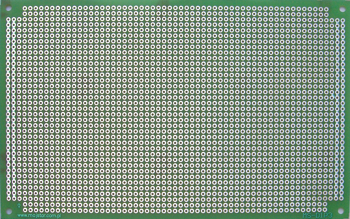

How clean is your power supply and how are you turning it on?
MarkT:
What do you mean with 'how clean'? I've soldered all parts to a universal plate like this one http://www.majstar.com.pl/images/plytki%20ok/dip3.jpg?PHPSESSID=76b250fdc6b40976f5fedc59bcf2f0c7. The parts/pins are connected with wires.
This is not my project, but it shows how I do it:
http://www.instructables.com/files/deriv/F2Q/270S/G9M4OS1A/F2Q270SG9M4OS1A.MEDIUM.jpg
To turn the Arduino on I put the (12V-1250mA Power-Supply plug) or (USB Cable) into the Arduino socket.
