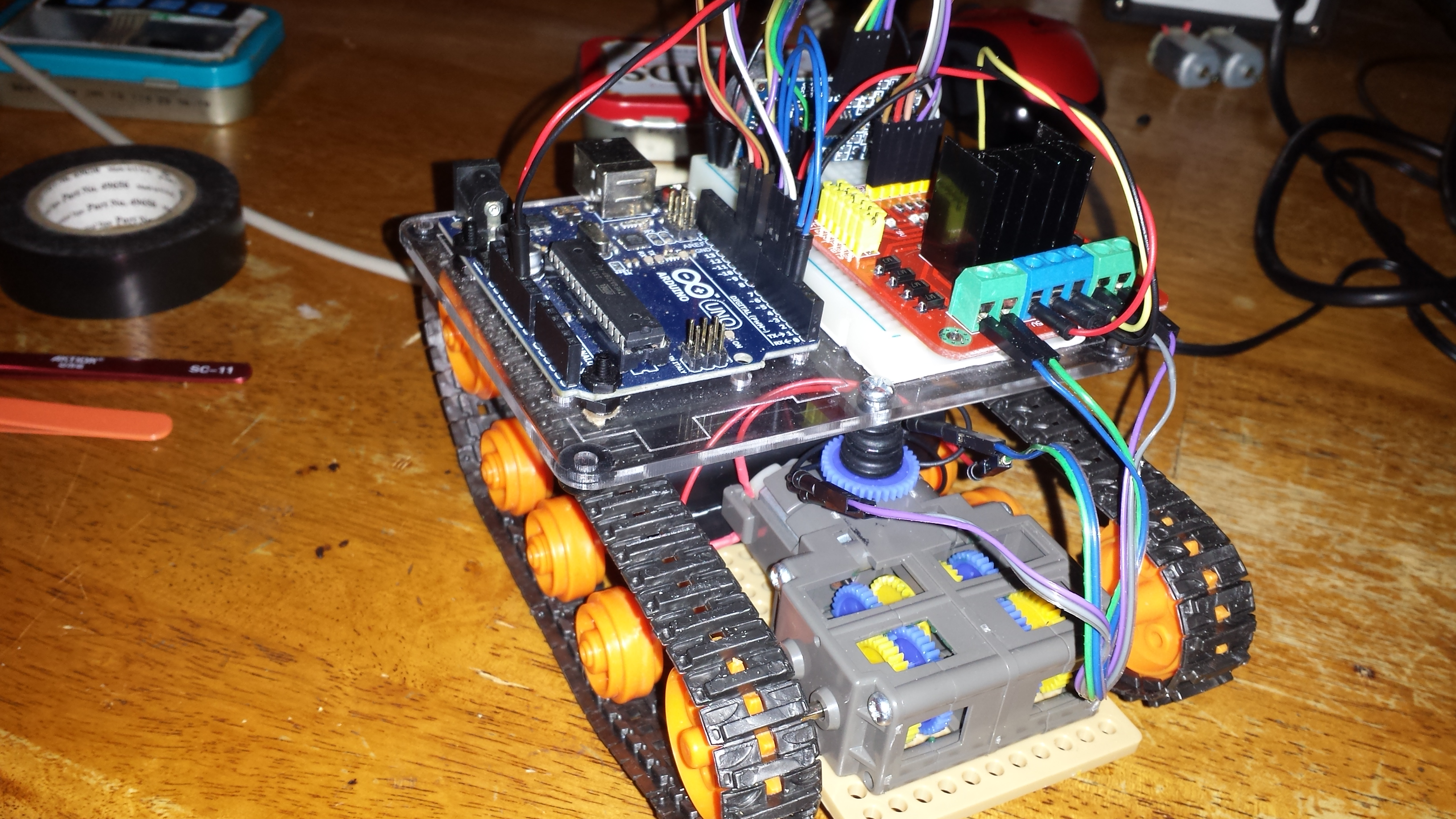

I just recently built this basic kit that I found on Amazon. It has a very similar functionality to what you are looking for and is a good starting point.
http://www.amazon.com/Tamiya-Track-Wheel-Set-TAM70100/dp/B00061HHRC/ref=pd_sim_t_4
In addition to that kit, you'd need a double gearbox for independent tread control. http://www.amazon.com/Tamiya-Double-Gearbox-Independ-4-Speed/dp/B001Q13BIU/ref=pd_bxgy_t_img_y
While it doesn't fit exactly with your original picture, you can combine all the components on their universal mounting plate really easily. http://www.amazon.com/Tamiya-Universal-Plate-TAM70098/dp/B00061HHR2/ref=pd_bxgy_t_img_z
Here is a picture of my project using these components: https://www.dropbox.com/s/r8gl4rc8fayvwwh/2014-01-15%2011.56.55.jpg
I used an Arduino UNO and a cheapo L298n breakout board with some on-board passives for protection. I think it cost me 5-6 dollars.
Annnd, my last note, the motors that come with the double gearbox kit are rather crude. They do work, and are controllable with the Arduino, but I upgraded to better 6v ones and I would suggest you do the same.
