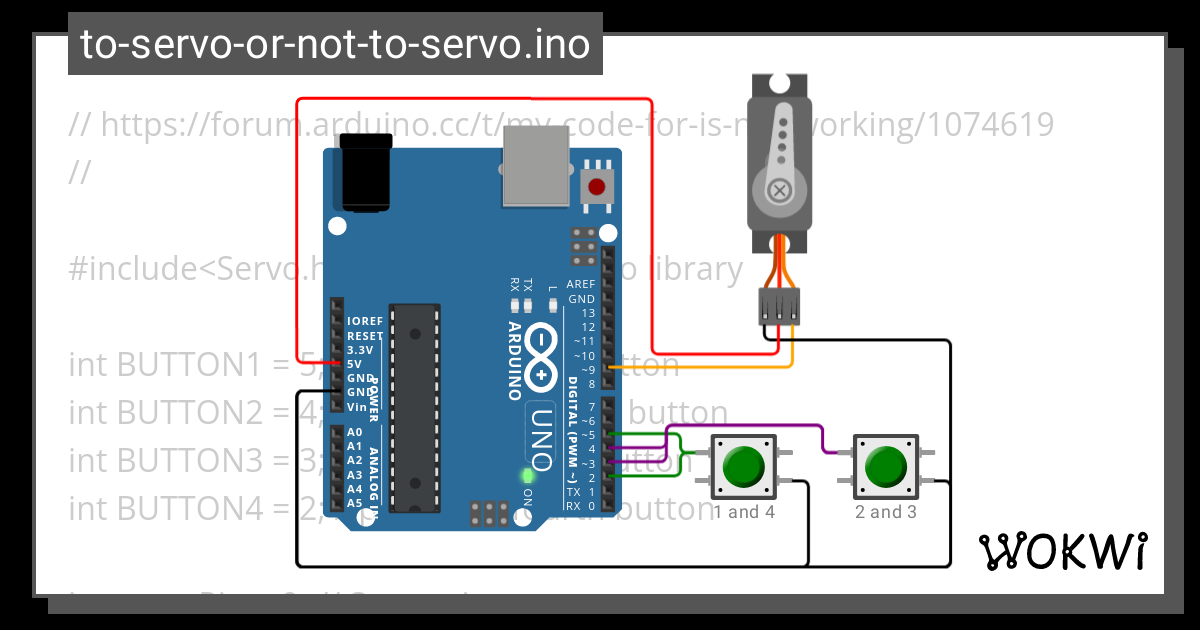

Suppose I take your sketch, then do what the others wrote, then put it in Wokwi simulation, then you get this:
> **[to-servo-or-not-to-servo.ino - Wokwi Arduino and ESP32 Simulator](https://wokwi.com/projects/353255619205199873)**
> Run IoT and embedded projects in your browser: ESP32, Arduino, Pi Pico, and more. No installation required!
The real question is: **Why does your servo motor not work ?**
Even a small servo motor can require a peak current of 500mA. Breadboards have bad contacts and jumper wires can be broken.
Do you have a multimeter ?

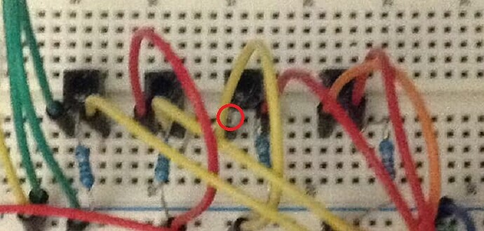

It still doesn't work the way I want it to even though I made changes in the code.
The view in tinkercad.
 ![Screenshot 2023-01-07 at 9.43.20 PM](https://europe1.discourse-cdn.com/arduino/original/4X/5/2/5/5258dd519ef9e78e8e921ffd168873b5dd9b04c9.png)

The project is exactly like the tinkercad that I posted. You check out the tinkercad version which also has the code.

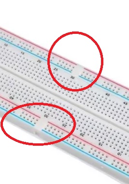

We need to see your project layout to check if your protoboard does not have these breaks in the side bus.
 ![protobreak](https://europe1.discourse-cdn.com/arduino/original/4X/1/5/8/1586401306bd1af06bced184c63266db1175ce5d.jpeg)
Do you have a DMM?
Tom... 😃 👍 ☕ 🇦🇺

![image1](https://europe1.discourse-cdn.com/arduino/original/4X/b/b/b/bbb23b7a5905dbacce449be75a067f9404439c63.jpeg)

Thanks for the photo, I think that is okay.
Can you try to make two test sketches ?
One that moves the servo motor with delays and another that reads the buttons and shows them on the Serial Monitor.
You really need a multimeter (some call it a DMM, but in my country it is a multimeter).

I already have your project working in the Wokwi simulator. Have you tried that link ?

Do you have a DMM?
The reason is, I don't think you have a good connection between the button legs and the protoboard sockets.

You seem to be using the internal pull-up resistors. You are ALSO using external resistors. Are those pull-up resistors or pull-down resistors? It looks like they are pull-down resistors which are fighting with the internal pull-up resistors.
You should eliminate the external resistors and wire the buttons between the Arduino pins and Ground.

It still doesn't work. Here's a top view.
