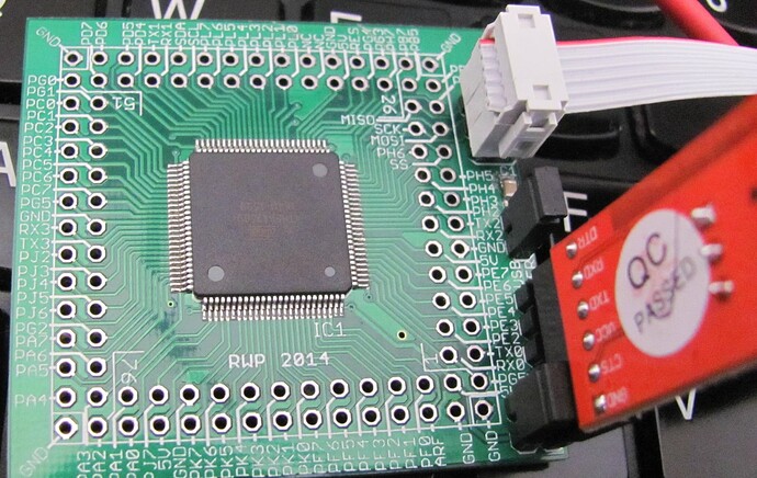

My custom made Arduino Mega doesn't drive LCD
Hello wonderful members
Following to my custom made Arduino mega board which was discussed here.

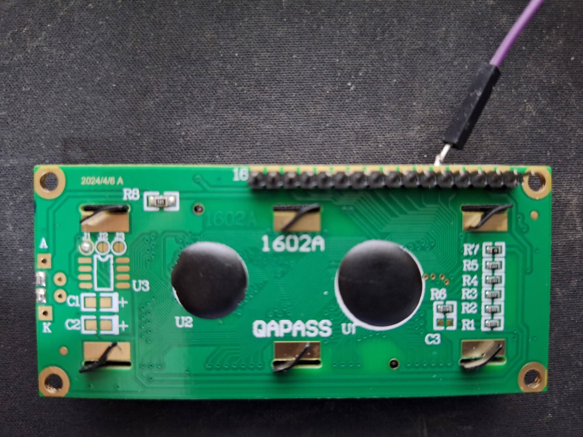

I am trying to drive a generic 16x2 LCD:
However I am unable to do so and output anything on the display no matter how much I try:
  • Potentiometer can adjust contrast: showing from nothing to blank squares on the screen
  • Tried with and without connecting RW to ground
  • I tried different LCD's on the board and they didn't work
  • I made sure every pin is wired up to the microcontroller properly
  • I even tested a code to set these pins to high so I make sure the assigned pins are being used and no problem with that all pins assigned gave 4.3V
  • I tried to program it with USBASP but same problem
- I tried the LCD with an Arduino UNO I have with the same code and it worked fine!!!
Could it be something with the bootloader or the set fuses or what could it be?!

:arrow_right: pin 1 is used for the Serial Monitor :arrow_left:
The ATmega2560 is the same AVR family microcontroller as the ATmega328P. The code should do the same.
However, the ATmega328P can deal with drops and peaks in the voltage and wrong use of the pins and can give peak currents with a pin beyond of what is in the datasheet (to some limit). The ATmega2560 can deal with nothing.
What is the 4.3V ? The ATmega2560 must have at least 4.5V, but try to bring it between 4.8 and 5.1V.
User CrossRoads is sadly no longer among us, but his website is still up: http://www.crossroadsfencing.com/BobuinoRev17/
I took two pictures from his website that shows the absolute minimum for a custom ATmega2560 board.
Do you see the 5 decoupling capacitors ? That means you should have also 5 of those (at least).
