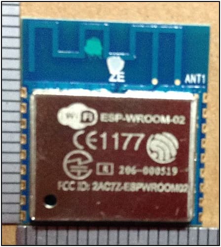

No matter what I did, I couldn't get the esp8266 wifi module that I bought last month to work. At first, I thought the problem was caused by the firmware and after some research, I updated the firmware, but it still didn't work. I tried a few more codes and it still didn't work, then I restored the firmware to version 2.0 and it still didn't work. After struggling a bit, I found a tutorial from an Indian content producer. According to this tutorial, a simple blink code could be uploaded to the esp8266 chip inside the module. I followed every step and uploaded the code. The code was uploaded successfully, but the blue light on the card did not blink. Afterwards, I thought there was a problem with the card itself, so I updated the firmware again and everything on the card was working correctly. I tried again and again, but every code I tried (such as esp and dht11) gave the error "esp8266 not found". If anyone encounters this error like me, PLEASE HELP ME.

i buy from a local store and error is in the serial monitor.Can't detect the module and module is not responding for at commands

Sorry I should have been more clear. But my module is in the first photo. And here is my code:

Note:I tried other similar codes and they all gave the message "esp not found". Personally, I do not think that the ESP is broken because when the firmware is updated, it is done successfully and the MAC and IP address of the ESP appear on the screen and also, the blue LED on the ESP blinks 2-3 times quickly when the power is supplied to the ESP.
here is my firm ware:ESP8266_NONOS_SDK-2.0.0.
sorry i can't attach files
Ok so that is called an ESP-01.
How have you connected it and to what ? (schematic please, hand drawn will suffice)
That is a code that should be loaded onto a different MCU like an UNO which can then control the ESP-01 if it is connected correctly. But the connections are rather important, and incorrect connection may damage your module.
So to re-upload that to the ESP, you must have connected it in a different way again. Which connections did you use to do that ?
