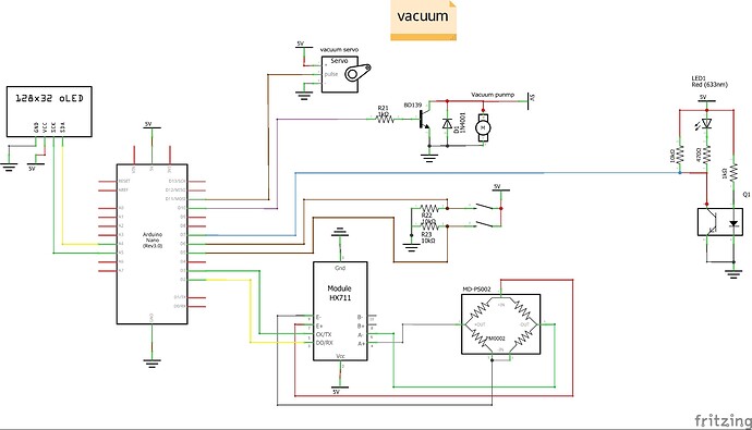

I created my first code using ArduBlock.
Almost everything works, only the part of the endstop does not work.
It is a vacuum meter that you can set, but if the "end stop" is triggered, the vaccum pump must stop and the servo must go up.
The setting of the vacuum works and the reading also works, only when the "end stop" is triggered, what I want does not happen.
What I don't see well. :confused:

First, you don't need to configure a pin as input every time you read it:
boolean DigitalRead(int pinNumber)
  pinMode(pinNumber, INPUT);
  return digitalRead(pinNumber);
Secondly, you don't need near the number parenthesis as you are using:
    if (( DigitalRead(7) && ( ( eindstop ) == ( 1 ) ) )) //?????
could be:
    if (DigitalRead(7) && eindstop == 1)
Thirdly, how are your inputs wired? I assume they are switches and your code implies you have a pull-down resistor for each input. Is this the case? You could use INPUT_PULLUP and wire your switches to ground.
Also, you are testing the state of the switches rather than the state change of the switches. This may be what you want but if you hold the switch down for any length of time you will get multiple increments or decrements of the vacuum.

yes i use a pullup resistor to the gnd.

I am trying to "clean" the code but the result remains the same pin D7 is not being read.

You also said something about a pull up resistor connected to 0v , which is wrong - pull ups connect to +5v .

Thanks TomGeorge,
this is my schematic
Thanks for the schematic.
Check your pump wiring, the way you have drawn it will short your 5V supply.
