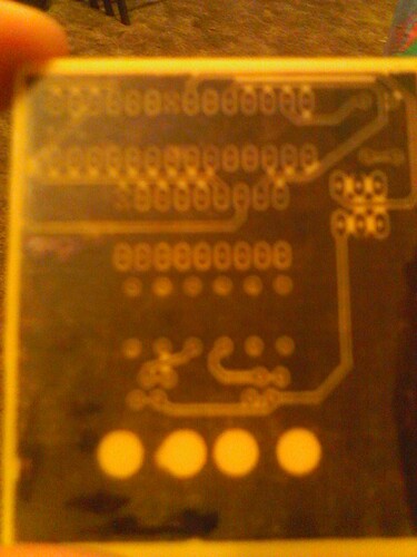

My first PCB (lousy pictures, sorry)
I haven't had a chance to strip the toner off yet (forgot to get acetone) but I thought I would share anyway this is my very first attempt at DIY PCB I am pretty happy with the results!
how did you align top and bottom layers?
When I drew up the PCB's I added an L above and below just outside the PCB itself for both the top and bottom layer. Then I printed them out on transparencies, I lined the "L"s up and taped the two transparencies together then I slipped my board between the two transparencies. Then I transferred them using the toner transfer method.

I will see what I can do to get less horrid pictures, I'm not claiming to be smart that was just the method that seemed logical to me :slight_smile:
