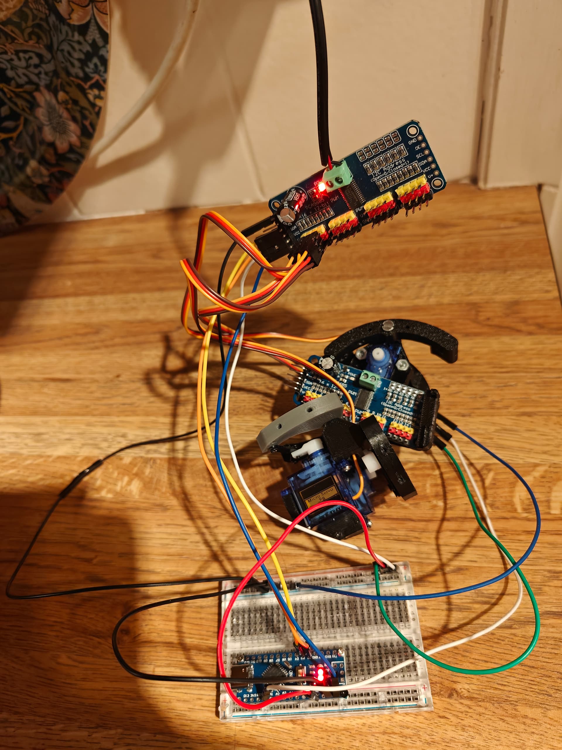

So,Im a bit of a beginner, but im enjoying trying to build the hardware part of this excellent project: Silicone Skin 3D Printed Realistic Animatronic Heart but I cant get the servos to move. I'm running the IDE provided, the serial monitor shows me that the signal is produced from the code... but nothing moves. I swapped the driver board in case it was done for, see image, to no avail. Tried a more powerful source of power, and nothing changes.
What am I missing?

There seems to be something terribly wrong with how the Nano is plugged into the breadboard and how things are connected to it
For instance, across the bottom of the breadboard is a row of pins labelled with a red +. How many of the Nano pins are connected to it ? Come to that, are any of the Nano GPIO pins soldered to the board ?
Only the pins in use on the Nano are soldered, but not "pointing down" to the breadboard, rather, "pointing up" for the female jumper connectors. The Nano seems to be screwed down to the breadboard, using the corner vias. also.
On the underside of the breadboard, are all the shorting jumpers removed?
[edit] I would remove the Nano from the breadboard.
I am glad that you can make sense of what you are seeing because I can't. The whole arrangement seems bizarre

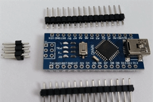

First solder all the pins.
Second move the Nano up so it straddles the gap in the middle of the protoboard.
Your current layout looks like it shorts all of one side of the Nano on the + bus running down the side of the protoboard.
By the looks of the screw in the Nano, you have it mounted OFF the protoboard, why?
You seem to have missed the whole concept of how a protoboard works.

None of the jumpers on the lower side is reaching down in to the breadboard, even if I understand that it looks like it,so no worries there. I thought that it would be enough to put the jumper cables in the holes of the nano, without soldering, but apparently not. As I mentioned, I'm really not experienced at this.
I'll solder the cables, and if not successfull I'll come back to this. Thank you!

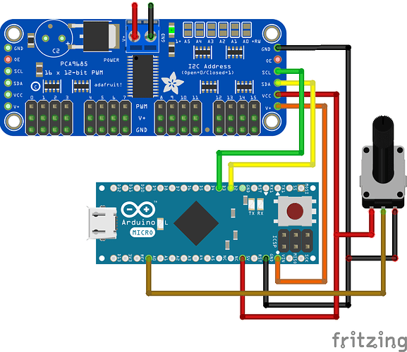

In the link provided there is a schematic, this is what I have been looking at.
Those are not the correct pins for i2c on Nano. They are correct for Micro. Google for Nano pinout.
Your picture shows 2x PCA9685? When using more than 1, you need to give them different addresses using the address solder pads.
THIS! No soldering, no removing the arduino from the breadboard - the pinout was wrong, the sketch for a Micro and I used a Nano. Thank you!

That should have been your first step
No, the Nano should have come with a length of header pins to solder to the PCB, then the Nano plugs into the protoboard.
