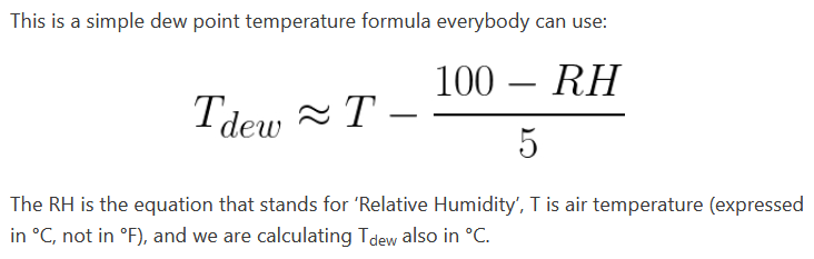

What Arduino are you using? The 8-bit AVRs don't really have a 'double' and it's just an alias for float and has only 6-7 significant digits.
If you aren't using an actual double, maybe the higher order terms are discarded by the precision of the arithmetic?
Have you tried a value against an on-line drybulb/wetbulb/humidity calculator? The result might help find any algorithm flaws.
Im using the Arduino Uno, to be honest I dont even know what "double" means in this context.
No I havent looked, I just know its reading about 20 deg c less than it really is
Since an uno doesn't have a "double precision float", all the calculations will round to only 6-7 digits of precision at each step

...it's going to throw away a couple calculations worth of significant digits. If those bits are important, the results will be trash.
Please post a link to the formula you are trying to translate to C language.
Hey, this is where i am stuck, math might as well be in a different language to me.
Thanks, would going to an Arduino Mega fix that then? im running out of pins on the Uno
Since humidity is very inaccurately measured by consumer grade sensors, you might just as well use this formula:

No, the mega also has an 8-bit processor and fake doubles. Try @jremington's soln:
