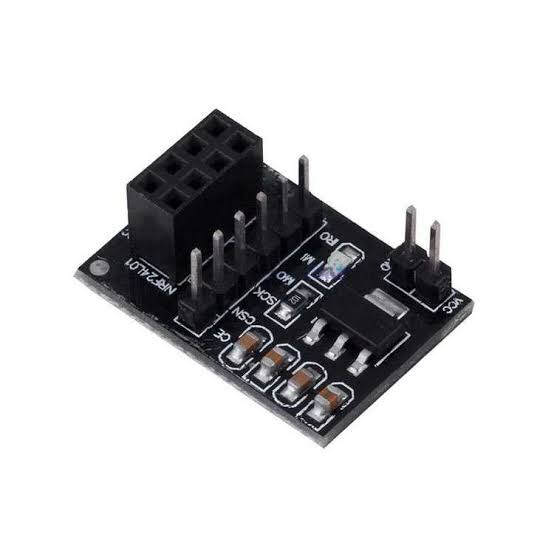

Edit: I also using nrf24l01 adapter module.

Actually i using 5v adapter for filtering. Can a capacitor help me?
did I not say?
if you not seen i used such adapter too.
oh I've realized now. okay I will try.
thank you so much it worked
