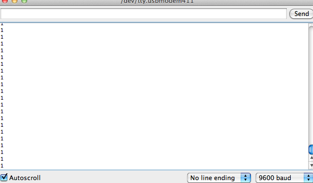

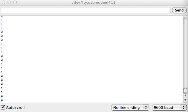

I made the code simpler .
int button = 12;
    pinMode(button,INPUT);
  int val = digitalRead(button);
  Serial.println(val);
when I upload the program, I get the bunch of zeros which is normal
when i connect the wire I get 1, which is normal.
but when disconnect the wire, I get 1 for almost 5 seconds and then the value starts to bounce between 0 and 1 for 3 4 more seconds and then it goes to zero.
one other thing which seems weird is when I place a wire which is connected to nowhere to the pin 12. I get the uploaded picture number 1 !!!!!! and when I take it out, for couple of seconds I get picture number 2. and then it goes to all zero.
it's so weird. the wire is connected to nowhere !!!!

  delay(10); //I bet that cures the problem.
As written, there is nothing to make the pin go High once the connection to Ground is released.
Do this instead:
    digitalWrite (button, HIGH); // turns on internal pullup resistor
Now val will reliably = HIGH immeditately whenever the switch is not pressed, and LOW when it is pressed.
