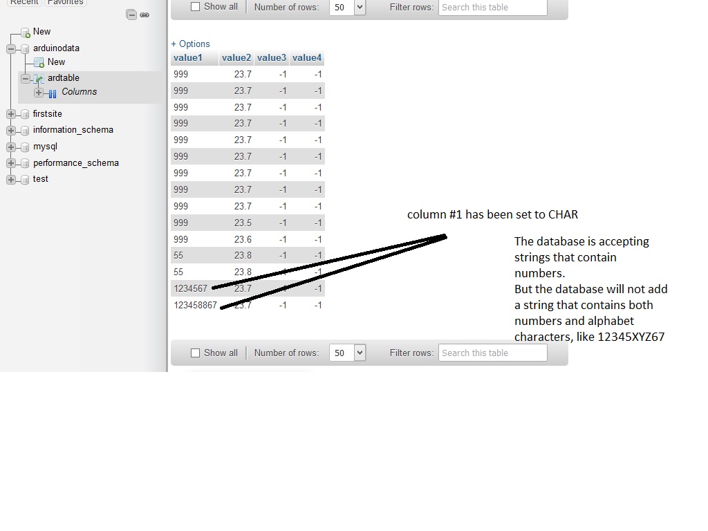

I've set a column format (eg column #1) to be of a ASCII type (well...... I saw the word 'COLLATION' in the settings, so I'm assuming it's important to set something, like ASCII type). Anyway, that's what I've done. Now, when I use the arduino to send a 'number' (in text character form), such as "1234567798", then the SQL table successfully adds this STRING (that involves 'numbers' only).
However, if I then decide to pop an alphabetic character inside that string.... such as "A1234567798" or "12345R67798" or ""12345XYZWABC67798", then nothing happens. That is, strings that contain BOTH alphabetic characters and 'ascii numbers' aren't getting added to the table.
So, right now......the table will only add STRINGS like "157" or "566" or "77", but nothing will happen (ie. not update) if I send strings like "1A5" or "555X12".

If somebody can take a quick glance at my really basic sql database screenshots and/or offer some advice to point me in the right direction, then that would be massively appreciated.
At the moment, my screenshots shows that I've set my column #1 to CHAR (with adequate character length). And another screenshot shows that I can successfully add ascii 'numbers'.

Within my webserver-side .php script file, the TEST STRING that I set-up is just like this:
$t1 = "1234588T67";
So.... in the above 'string', I have included the character 'T' toward the end. So that would be an example where the database does nothing if I send it that particular string.
However, the database will at least become alive if I send a string-encoded 'number'.... like..
$t1 = "123458867";
INTERESTINGLY.... sending "-1" works too.... such as:
$t1 = "-1";
will successfully add a '-1' to the table, as if the column is stuck in a number or float format mode?
And the table inserting/update php code just looks like this:
$sql = "INSERT INTO ardtable (value1, value2, value3, value4) VALUES ($t1, $t2, $t3, $t4)";
