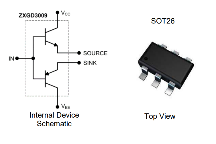

So: How about driving the high side N-FET's with a conventional stock standard low side MOSFET driver, fed by a 10 volt higher voltage than the bus? A low side driver is cheap, readily available off the shelf, even in these challenging times in the IC market.
As I see it, there is two ways of doing it. Common ground or "isolated ground". With common ground the voltage needs to be increased to about 10V over the rail voltage. The feeding circuit does not need to be isolated as the ground is shared. The other way, where source acts as ground / "isolated ground", the voltage generated basically only has to be +10V in reference to that ground. The source of the mosfets.. In this case the unit generating the voltage needs to be isolated.
Isolated ground:
Common ground:
Driver:
Please shoot your thoughts!
