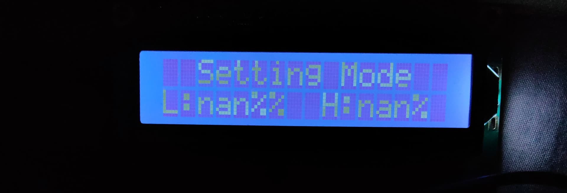

Nan keeps displaying on LCD
Got almost everything working except for the DISPLAY SETTING MODE. Can anyone point out what's wrong? Also, the motor doesn't turn off when the moisture level reaches a high percentage. Is it possible that it's because I haven't fixed the setting mode?
For context: I'm making an irrigation system, there are 3 buttons that are used for the setting mode.

The value of erased EEPROM is 255 or 0xFF, not 0, so its likely you never set the initial values in EEPROM.
nan is what will be displayed if a float variable contains invalid data, and means "not a number".

Thanks! This solved the problem with the LCD. Do you notice anything else incorrect with the code that's making my motor not turn off?
I guess the problem is here. I'd have thought that this test should be inverted.
If the current moisture content of the soil is less than the expected moisture then surely you want to turn on the water.
  // Control motor relay based on moisture levels
if (moisture < setL_moisture) {
  digitalWrite(motorRelay, LOW); // Turn off the motor
  digitalWrite(motorRelay, HIGH); // Turn on the motor
Thank you!! Everything's working perfectly now.
