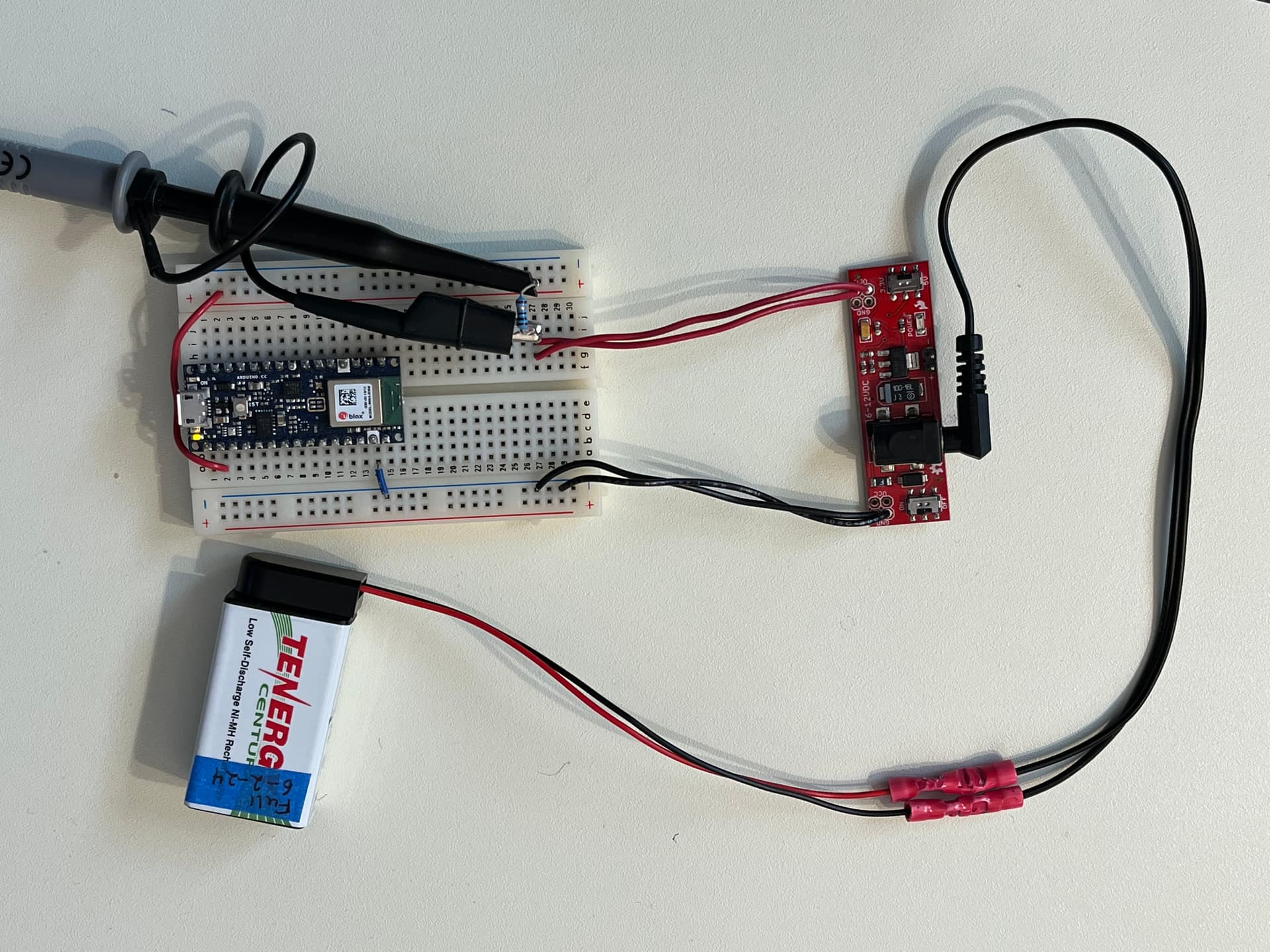

Hello, I am measuring sleep current of about 90uA (and also spikes up to about 600 uA) and was expecting to see < 20uA. I am trying to get this board to run a year or more on a coin cell battery. I have been trying to figure out what is causing such high current during sleep. My sketch blinks an LED on and off. To minimize sleep current, my sketch disables USB and stops Timer1. I have also set some of the floating IO pins to outputs (specifically, IO lines going to sensors which are un-populated on the Nano 33 BLE). In addition, I have cut the 3.3V jumper on the board and am powering the board with 3.3V directly on the 3V3 pin.
Current measurement is done with a 1x scope probe across a 10 Ohm shunt at the 3V3 pin with USB cable unplugged from the board. While the LED is off, I am measuring average sleep current about 5x higher than I was expecting. Any ideas what peripherals (aside from USB and Timer1) may be on by default and causing high current during sleep? The sketch was uploaded using the Arduino Cloud IDE.

Hello, Please see the requested details of my setup below. As requested, here is a link to the 3.3V LDO and the 1x oscilloscope probe used. Before the test I confirmed LDO VIN=8.70V and VOUT=3.304V.
SparkFun PRT-13032 (Breadboard Power Supply Stick - 5V/3.3V)
Cal Test Electronics CT2678 (1:1 Passive Oscilloscope Probe, 15MHz, 1MOhm Input Resistance, CAT II 300V)
Those are all great suggestions. For my testing I believe there are no test setup related leakage paths disrupting my measurements. I was hoping that the community would also have been keen to get this board working at low current during sleep. Since the initial configuration details of the board are opaque to the Arduino user by design (i.e. fuses and initialization that happens "behind the scenes" prior to running the setup() procedure), I am trying to determine which peripherals (such as ADC, timers, UART, USB, TWI, SPI, ... etc.) are on by default (or turned on during board initialization and/or by fuses) and how to shut these down before sleep so that those peripherals don't consume extra energy during sleep. Again, maybe the Arduino team has already encountered this since some customers want to run this board on a battery. Any help is greatly appreciated.
