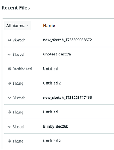

I see in the Cloud editor that when ever I go back to devices or open Things a new sketch untitled is added.
So I end up with a few untitled sketches or Things and then the editor tells me that I have reached my plan limit.
Then also the Cloud editor does not "forget" I played around with the Cloud editor in Aug 2024 and now it shows that device was added Aug 2024.
I did delete all the Things and Sketches and start over but the Device still shows that it was added Aug 2024.

But I still have the history list in Home > Recent.
It won't cause any problems. Just ignore it.
