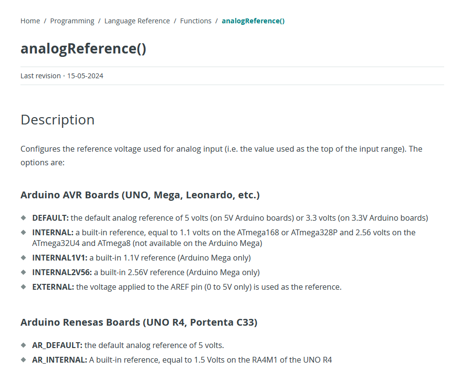

The Every falls AFAIK under the MegaAVR family (ATmega4809).
Bottom of the analogReference page.
Leo..
Arduino megaAVR Boards (UNO WiFi Rev2) is not Nano Every.
I know, and you know the Nano Every has the 4809.
The 4809 is mentioned once, halfway down that list.
I didn’t see it at first, I certainly don’t expect a newbee buyer to understand that.

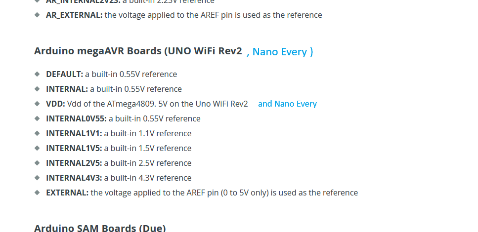

Possible solution:
Page 175 of the ATmega4809 datasheet confirms that list.
Leo..

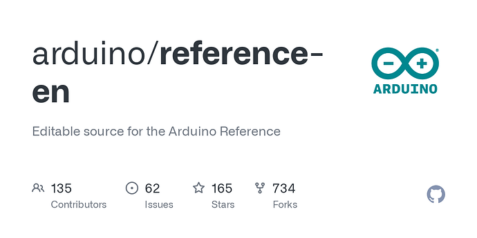

There is a GitHub site for reporting issues with the arduino reference documentation
You can report an issue, or a pull request with a solution.
