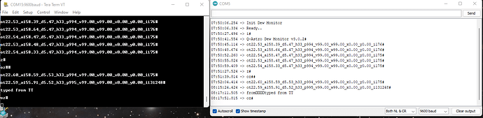

I am trying to get some existing code to work over BT using the HC-05. I am able to send & receive through software.serial just fine. The issue I am having is that when sending commands over the BT serial connection (using TeraTerm) the command shows up in serial monitor of the USB connection on the Nano but it doesn't actually execute that command on the nano and return the data. If I run the command in serial monitor it runs just fine and everything that shows up in the serial monitor shows up in the serial connection of the HC-05. I can see data going both ways so I know it isn't a hardware or cabling issue. I also have a 2.2k & 4.7k resistor as a voltage divider on the HC-05 so I get 3.3v. Using pins 11, 9 for rx/tx
The nano has a BME280 sensor on it that is used as part of a dew heater for a telescope. Sending oz# should return a string of temp, humidity, etc data from the BME along with some data from 2 DS18b20 sensors.

Screenshot showing data going both directions & ouput when entering in oz# command
Last of oz# was sent through TeraTerm on the HC-05 serial connection, which is received on the Nano, but does not do anything with it.
Got this working. The tab that was sending the temp data was only sending it via the serial port, added lines to send via the BTserial and it is now working as expected.
