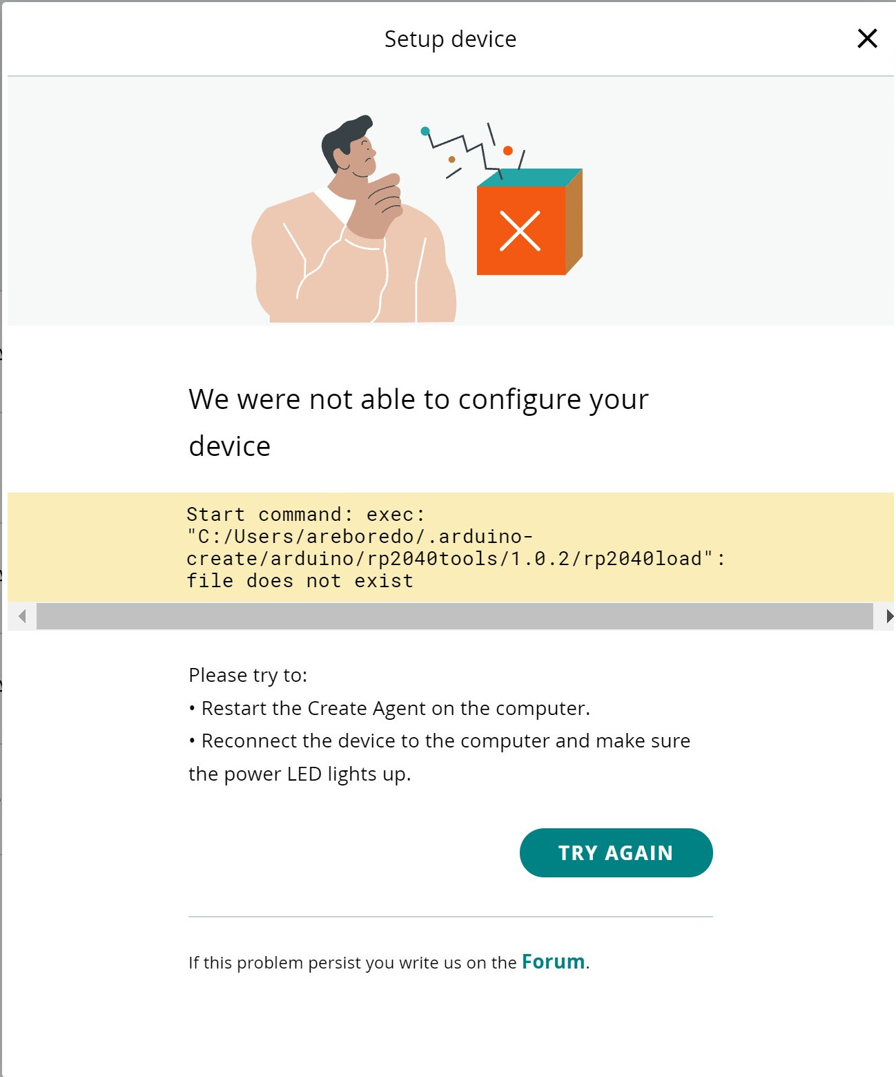

I'm having problems connecting a RP2040 just out of the box
problems to setup a new device in the IOT cloud
Arduino agent latest version
no files in the directory agent is looking for.....rpload
and problems in Arduino IDE not uploading even default sketchs
the board has jus been unpacked... and wen connecting there is a loop of RGB blinks alongside with the orange led
I dont know if there is a previous step to do but nothing seems to work, Libraries updated in Arduino IDE (mbed RP2040 ver 2.5.2)
I think i'm missing some previous requirement or driver but no clues and no idea where to look for information.
Many thanks in advance for any clues on this

Hi @Ale-X.
How much of that path does exist?
Can you think of anything special about that path, or any reason why the Arduino Create agent would not be able to install the RP2040 tools there?
Thanks In0
the path is there but empty directory:
....arduino-create\arduino\rp2040tools\1.0.2
this was my first thought to look there but really no idea why it is empty.
permission are ok so far, because directory has just been created...
I guess the installation of the RP2040 tools failed for some reason. I simulated the condition and found that Arduino Create Agent is able to recover from this situation on my system. So it's not the case of the installation being poisoned by this empty folder as I suspected at first.

  "DownloadStatus": "Pending",
  "Msg": "Unpacking tool rp2040tools"
  "Msg": "selected baseDir tools_windows_386/ from Bz2 Archive Content: [tools_windows_386/ tools_windows_386/rp2040load.exe tools_windows_386/picotool.exe tools_windows_386/elf2uf2.exe]"
  "Msg": "Ensure that the files are executable"
  "Msg": "Updating map with location C:\\Users\\areboredo/.arduino-create/arduino/rp2040tools/1.0.2"
  "DownloadStatus": "Success",
  "Msg": "Map Updated"

Finally got the answer / cause of problem,
maybe somebody could find it useful.
Reason of failure is Antivirus as the files @ username.arduino-create\arduino\rp2040tools\1.0.2 are deleted by antivirus immediately after they've been unpacked!
I found it using IDE instead
as I found that the files installed by board manager @ username\AppData\Local\Arduino15\packages\arduino\tools\rp2040tools\1.0.2are deleted after installing the board... but just when they're called to be used first time.
the Antivirus installed is Webroot endpoint protection ( :rage: !@#&§) but I think I cant disable it as it is remote managed by IT admin of My enterprise, so I'll try from my home computer .
I don't know if there is a way to prevent the antivirus to have this file authorized to run
or maybe Arduino developers could make the necessary to have these .exe files not recognized as potential danger...
